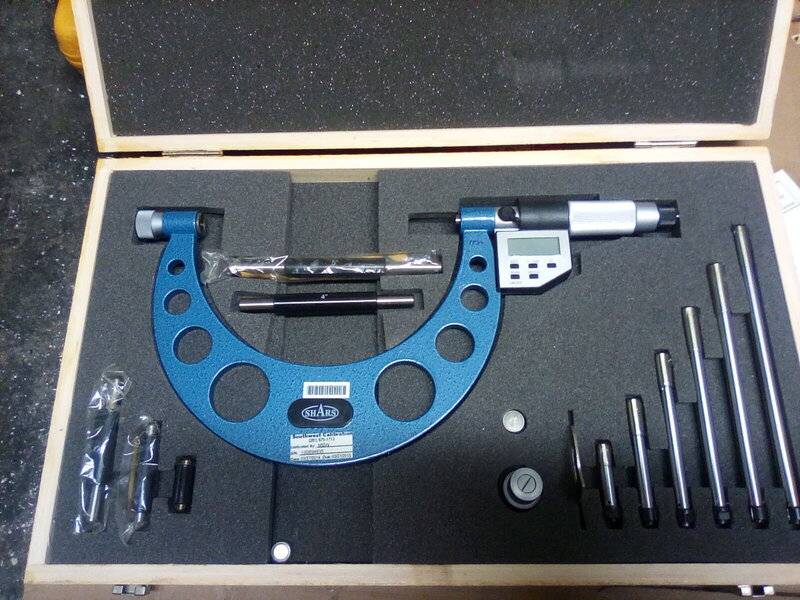

I browse FB marketplace just to see if I can find a deal on something I need/want and have come across some good deals.
Picked this up for $50 the other day, looks brand new, although the calibration expired in 2015 I still think its a good deal and more accurate than Ill ever need measuring to .00005".
I'm not a machinist but know my way around tools, though the little cap next to the anvils has me wondering what its for...???
From Right to Left, and Bottom to top:
1) Rods to measure 0-6"
2) Tool to remove battery cap
3) Larger ratchet cap for thimble (insert appropriate length rod and install ratchet cap)
4) Anvil for fixed side of mic
5) Calibration standard 1"-5"
6) Mic
I appreciate that, I thought it was for the thimble just wasn't sure the how and why...So what is that advantage over the black rachet?

It is hard to see, but the black portion is threads isn't it? If it is actually a cap, it could be just a protective cover for the ratchet cover, or the black is a non-ratchet cap, in which case, you can use either.

It appears to be knurled for use. I was playing around with it last night using various standards to zero it out then measure some different sized items and re-verifying that It returned to zero.
The small black thimble allowed me to move in .00005" increments, where as the larger thimble moved in .00100ths +/-.
As I understand and please correct me if I'm wrong, but when measuring I tighten the mic up until I get one click on the ratchet? Does that sound correct?

and the rods go in from the anvil sid
That is correct there is a slot for the dowel on the anvil to seat and the cap holds it in place.
I looked for an owners/operation manual online but couldn't find anything specifically for that model.

I rotate a couple clicks, when it is ratcheting, it shouldn't be able to tighten any more. It is more a feel for it thing, and getting used to obtaining a proper measurement.
