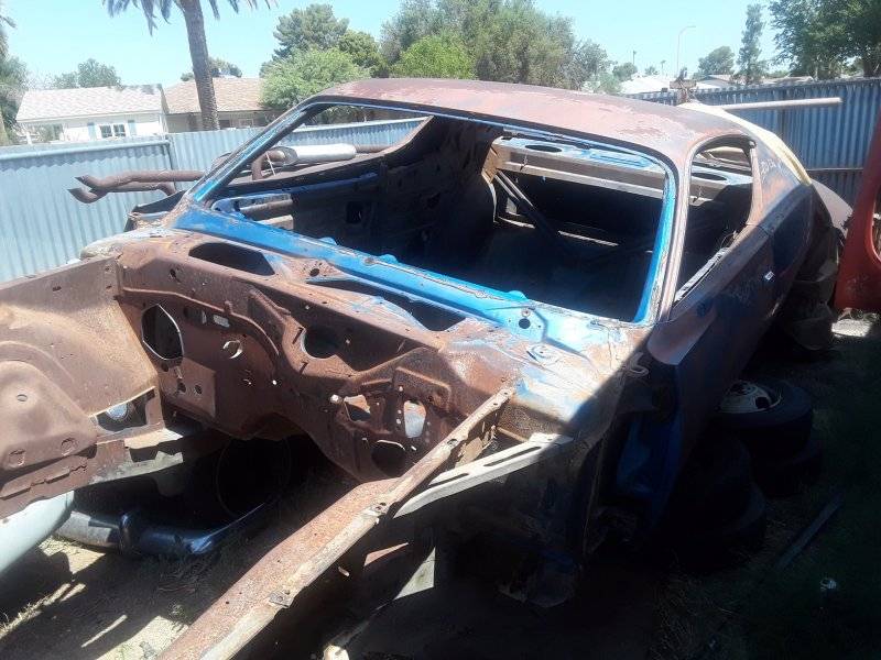

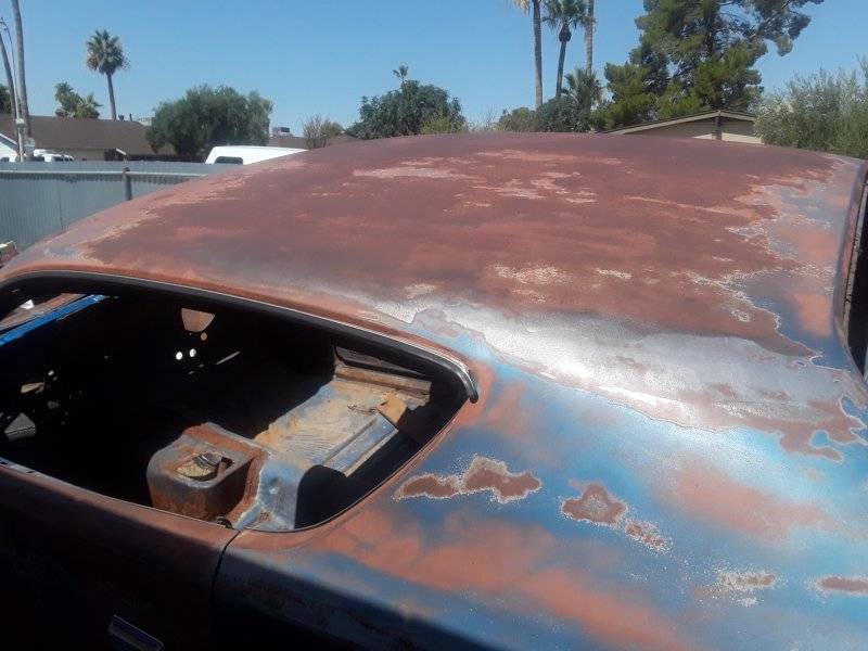

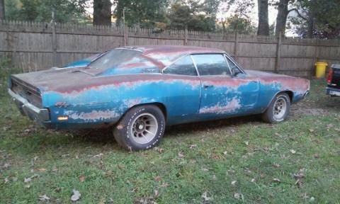

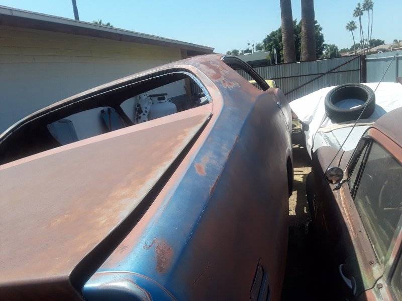

I am building a 71 Charger that was originally B5, however now it has a red passenger fender, black (EDP) drivers side quarter skin, black (EDP) drivers side lower quarter patch and a EDP air grabber hood. I would like to try and match the existing faded B5 patina that is on the rest of the car if possible.
I am thinking that I would need to paint the red fender and EDP panels the same manner which the car was originally painted and then patina them is some fashion.
My other option is to just leave the mismatched panels as they are and roll with that which I would rather not do. The objective is to have the car look "field fresh" however it will have a new interior along with a new 5.7 Hemi and TKX trans. The engine compartment, interior and trunk will all be new and nice, I am going to paint the engine compartment with B5 as well probably inside the trunk and perhaps the door jams.
Just for clarity, I am not asking "if" I should do this I am asking for advice on "how" to do it.
Just prime and seal it, or paint it. You might spend near the money "preserving" patina than simply priming/sealing it. Whatever you do, do NOT simply spray clear gloss over it! If you truly want to preserve the look of what you have, clear gloss destroys it. Then, it looks like you have phony "patina". Also, don't use linseed oil. Yeah, it looks great for a month, but that oil does you no favors when it comes time to actually paint (or seal, or even wrap!) the car. Nothing will stick to it, and you are stuck with oil-impregnated sheetmetal.
Looks like you could spray some red oxide, then GB5 basecoat over that, then D-A through the GB5 in spots to get to the red oxide and bare metal.
It'll take some experimentation. You'll probably need to blend into the adjacent panels. You can put a satin or flat clear over everything if you want to preserve it.
You can likely find info on the process on the internet - lots of movie & TV props, facades, etc get aged for filming.
Very helpful, thanks. I have looked online quite a bit concerning this issue and haven't found a lot about matching patina, there is quite a lot about "patinaing" a vehicle, faux patina, etc. but not a lot about making a new panel look like an existing old panel. I realize that its all related but was just thinking it through and decided to post this.

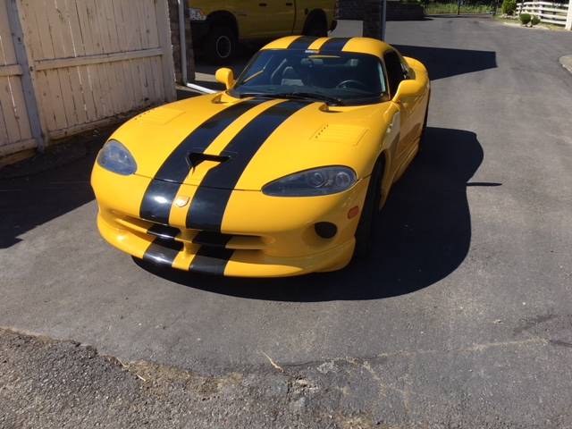

This car is going to be nice on the interior and the engine compartment, but I really don't want to paint it for a variety of reasons. As I said, I have a pile of nice cars such as...
