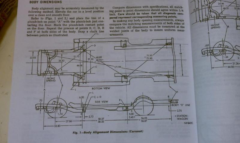

Propwash, I've been reading your build thread too and have my car up on jack stands under the frame rails. I can't quite get the car perfectly level. I know the cars would not have been built to the strictest of tolerances at the factory and there doesn't seem to be any totally straight areas to get a truly accurate reading.
The chassis must be stiff as when the car is as level as can get it I can move the driver side rear jack stand. I will need to wedge a shim in there. I think the car was probably this way since day one.

Also about the level on your car, Is your shop floor level? Mine was not so I compensated for that. Here is a drawing that may be helpful when measuring.

My my car is on my driveway (unseen from the road) and the ground is very uneven but I have used shims with the jack stands to get it level but it's not quite there. I'd like to get it bang on but I think it may have been this way from new. Although the floor pan has been poorly repaired with sheet metal and the X brace that goes behind the rear seat has been removed by a previous owner (I bet I can't buy that repopped). I'm not convinced this would have caused the problem though.

Thanks for the drawing also.
