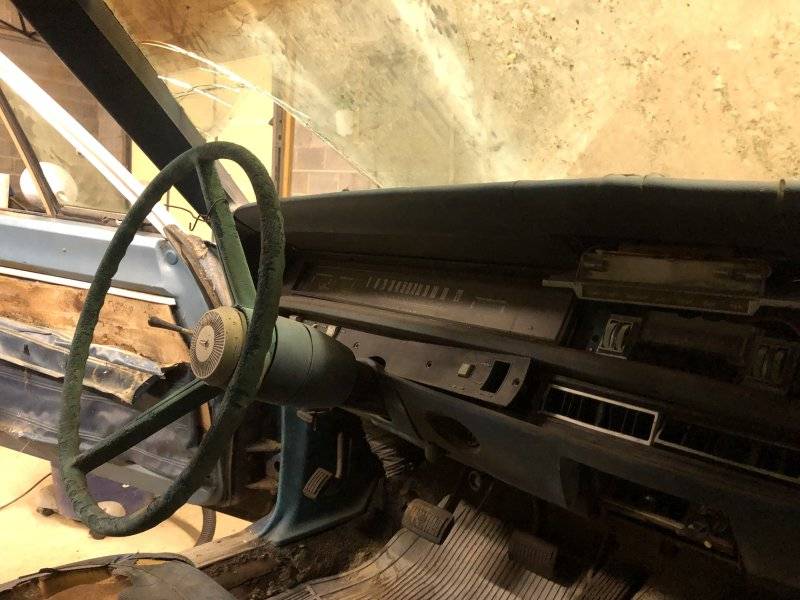

Yes I have the fender tag. Plus look at the firewall and dash. It’s obviously an AC car. Car had never been touched or painted. Has the numbers matching transmission and engine also. They didn’t order many options on it but they did get AC, three speed wipers, and fender mounted turn signals. Came with painted steelies, dog dishes, and obviously a coupe. F

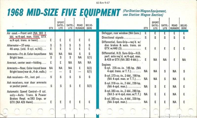

...no 383 4-speeds with a/c.
I believe it was no 383-2bbl 4spd w/ A/C. Seems there's some printed Plymouth stuff to that, and ordering info for the '68 Charger also to that limitation. Lemme look a bit...
As almost always - info I lifted from Hamtramck Historical. I don't have the ordering guide for Plymouth, but this is from the dealership data book:

For what it's worth
M
383-4bbl four speed a/c cars are not common but they do exist. It was a combo that was OK to order.
