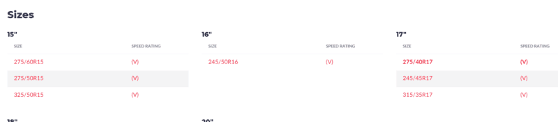

i was all set on these for the front & rear. guess what... the tires are on intergalactic back order. Not finding stock anywhere, i called Nitto, they said they are in production, no idea when they would ship & could be months.... ARG!!!
Trouble is, I'm having problems trying to find that same size rear 275/50-17 , seems to be an odd size for whatever reason. i might have to settle and the the shorter 275/40-17 , this seems be mfg by a few different tire mfg and readily available.
suppose i could go with the M&H at that size. but it's much more then i wanted to spend.

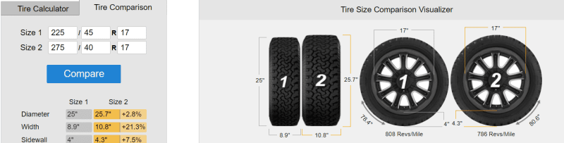

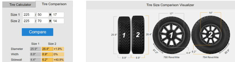

for the front , i was aiming at a 17x7" Rim with a 225/45 (or /50) -17 , this would be a little shorter then the 225/70-14 i currently have, these rub (touch) the front or the fiberglass fender , going in reverse, full lock. wanting to avoid this i thought i could get a 'shorter' tire.

Buy a pair of the tires and wheels you want to run on the rear, and when you get em, try em on the front. If they work, then you can run the same all around. If they don't, then you will know what won't work, and can go smaller.....

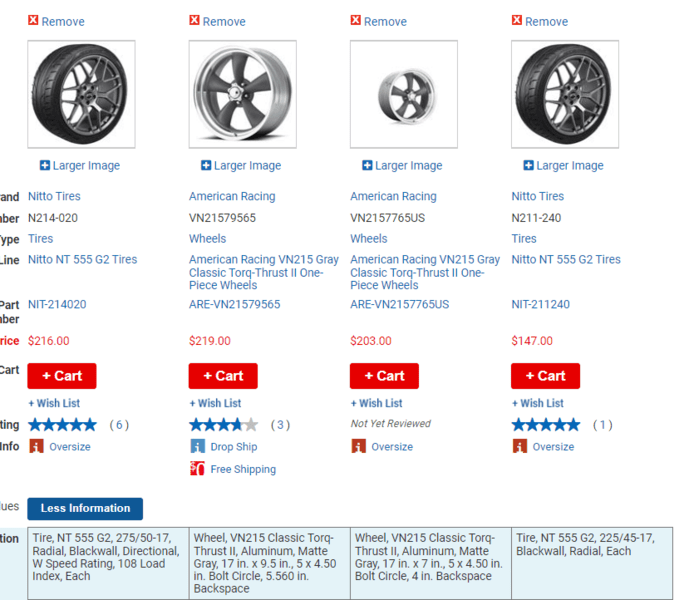

Although i would love to get a taller tire on the rear 275/50, being limited on mfg who make that tire and both were not available anytime soon. I called Nitto and they said they were "in production" but no idea when they'd ship and Summit said they have the M&H Racemasters on back order for months although their website says 1 week to ship. Jegs showed the same, they wouldn't answer the phone so i couldn't confirm that.
Not getting something i can obtain quickly made my decision. if something were to happen and blew out a tire, the car would be down for a long time. I'm taking 33's suggestion and "biting the bullet & go with a 40 series" That's got 100's of choices to pick from and stocked.
went with the American Racing Torq thrust II in the 17x9.5 (5.5BS) in the rear with 275/40 & a Nitto NT05
and a 17x7 (4.0"bs) in front with a 225/45 & a Nitto Gen 2
I'm expecting something like this... I'll post some pics once i get everything assembled.
