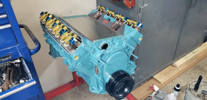

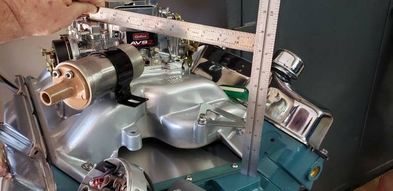

I just put a set on my 440 with MW heads along with their flat valley pan and an INDY
Dual plane intake. I bolted the intake to the passenger side head first and took a feeler
check on the other head to check the gap and for checking parallel. The gaskets come
in two different thicknesses! I Likey! Nice Feet!

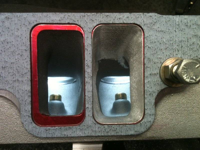

True MW sized port openings have top of the port higher, the bottom of the port lower, and the outside of the port wider....... than a std port opening.
