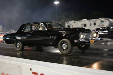

I run MW manifolds with full exhaust, Car runs 10.20's
