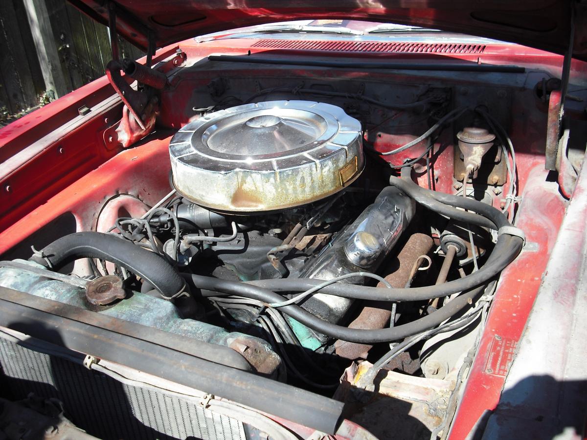

The 65 426 "Street Wedge" was a single 4 bbl 365 HP. I've seen many with 2x4 of every configuration. Hope it's a good "find" for you. POST PICS!!!

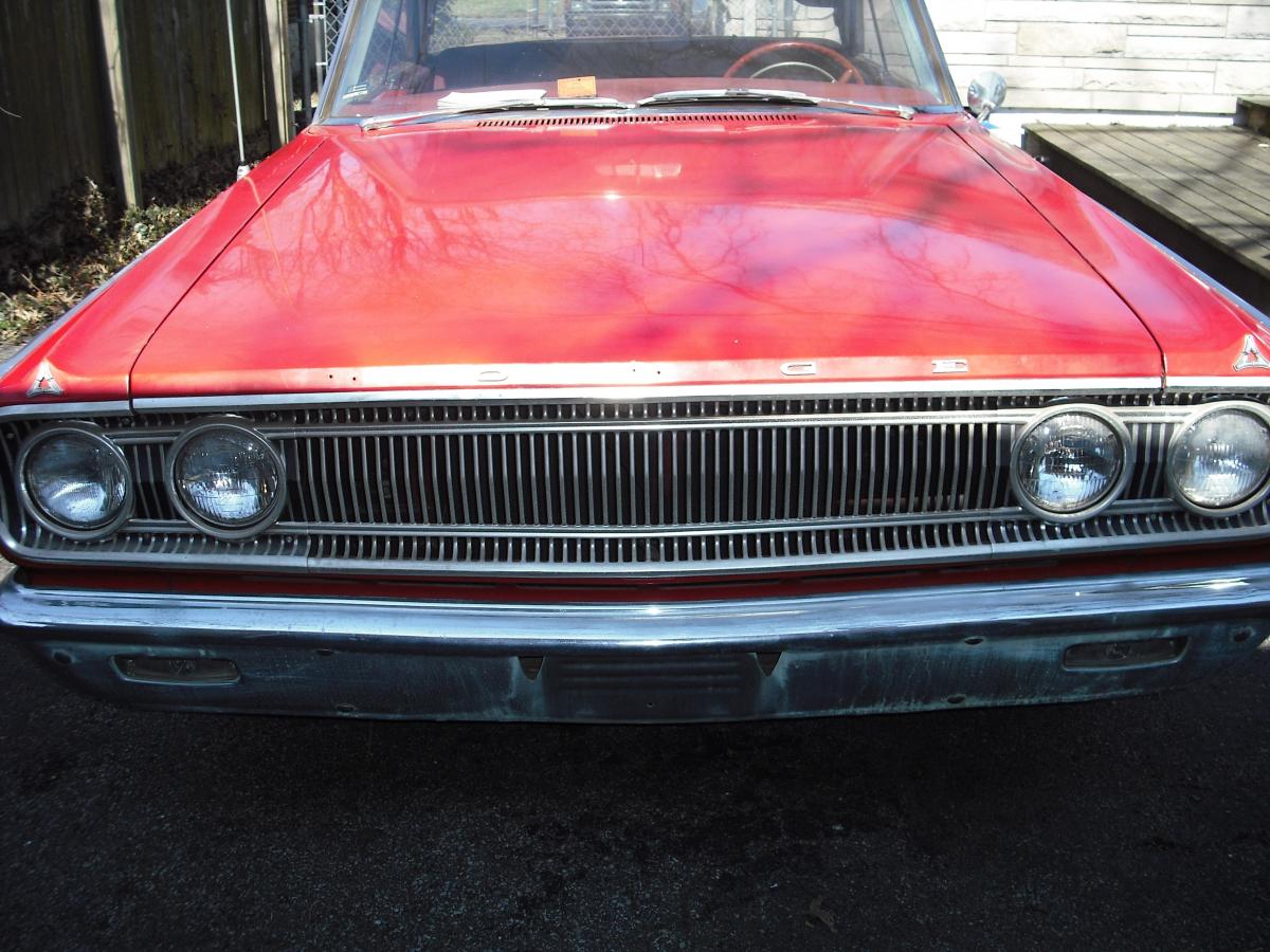

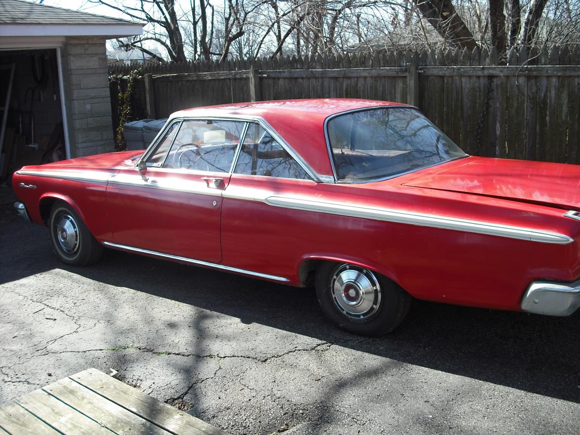

Here are a few pics,street wedge/auto,Not what I hoped but pretty nice.
So did you buy it? How much were you able to get her for? Nice car! Although it needs some work, but doesn't look bad. How's she run? Good luck.
