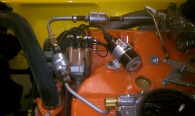

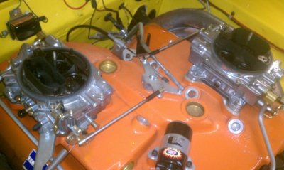

Ok so I bought the 63 Polara with a 426 Maxi in it, have to thank everyone for their help/input - It does need a new distributor (no vac advance) and new carbs, it currently has chokeless Edelbrock 650's...runs awesome, but would like to make it a bit more streetable... I have a couple of questions:
what plugs are you guys using?
what fuel are you guys using?
what is the best recommended distributor/ignition system?
would dual 600's with chokes work best?
looking for advice/guidance from folks running with 426's so I dont have to reinvent the wheel on this stuff... also, are we able to fit a power brake drum and still maintain the factory headers? would like to go 4 wheel power disc... pics attached...

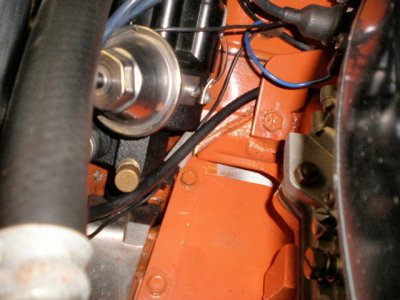

I don't think you will find a booster that will clear the manifold.Even if you do the heat will probably be a problem,the manifold temp in that area can go to 400+ degrees.I made a shield tjust to keep the heat off the origional master cylinder.Also one to keep the passenger side manifold from burning the paint off the valve cover.

thanks for the brake info, might have to lose the factory headers and go with some aftermarket to be able to obtain the disc brake mod..... what are you running for a distributor/ignition/plugs/fuel? how does it idle and respond?
Distributor is recurved 1963 Chrysler 300J dual point tach drive,plugs are A32 Autolite,solid wires and I run 101 low lead AV gas,couldn't ask for it to run any better.

The hemi cars that had power brakes used an offset bracket to mount the booster higher for valve cover clearance, but that was the later B body. I think someone reproduces this bracket but not sure about the linkage. May be worth investigating. Or you may be able to bolt on one of those small boosters. Won't look right but should work well. Hydroboost is a good suggestion too.
If you run the factory manifolds you can use the small Midland Ross A-body booster if you mill 1/4" off the manifold mounting surface but heat is still an issue,with headers I guess you could use just about anything..

its got 11-1 compression and chokeless 650's on it right now... as well as an old school distributor (see pic) & unknown plugs (havent dug into it to deep yet) Thinking at this point is hotter plugs and a better more modern distributor and ignition....super unleaded and some Octane boost... perhaps some 600's with choke?? While it definately kicks *** as it sits.... it doesnt like to idle and wants to go. Just trying to make it as "streetable" as possible, Or more streetable than it currently is.
