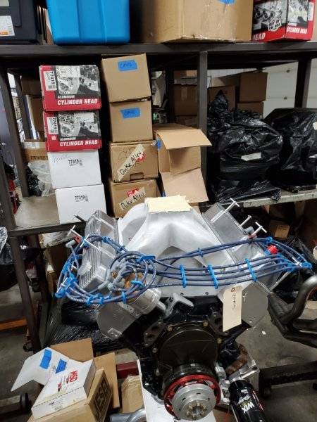

My 574 B1MC motor made 1060 hp on the BES dyno. BES did the work, and they hogged on the heads pretty good. Especially the push rod openings.
