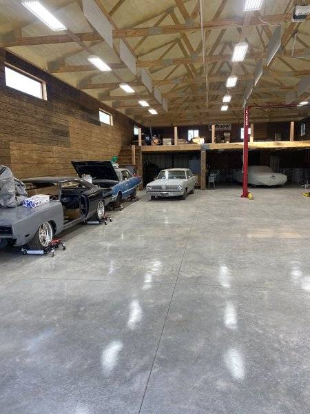

My metal shop was fully insulated and it had heated floors. Never had an issue with condensation. I think keeping the floor warm was the key but the insulation also helped.
