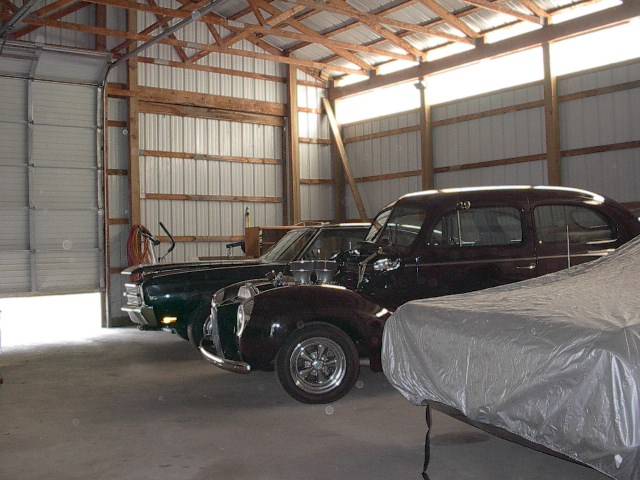

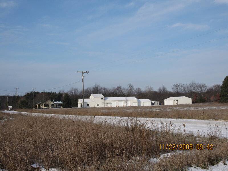

I put up a self framer. I also erect pre-enginered buildings with the Bro-in-law involved here, but the pricing is extremely associated to them as well! This building package was around $22,000 CAD at the time excluding lock up and interior finishing. Sorry about the pics, after FABO did an upgrade they went to attachments, but they are there. I love my shop. It was very cost effective and fast. Now having said that, it is only 2x4 walls and I could have gone 6. It stays plenty hot, but I could have been more efficient with the extra insulation. I went 32' X 54'. 32' is deep enough for a full truck to be in with ample room on both ends, and the 54' I took 14' from for office / bench area and mezzanine. This basically left me with a 32' x 40' shop. I bought retractable air hoses as I hate rolling them up and did all the electrical in exposed conduit. You can not have enough light either, plan for adding on if you can't afford it right now. I can have three projects sideways in 32' and one in the doorway bay. I can even have one into the workbench area totaling 5 in the shop at a time. That's too many (maybe!) but the excess room is nice. Here is a link to a thread about it. I know I could have easily used more space, but I'm very happy with the layout. However as said above, "It will be too small!" no matter what you build.

Love the layout that's a really nice shop/garage/mancave :thumbsup:
