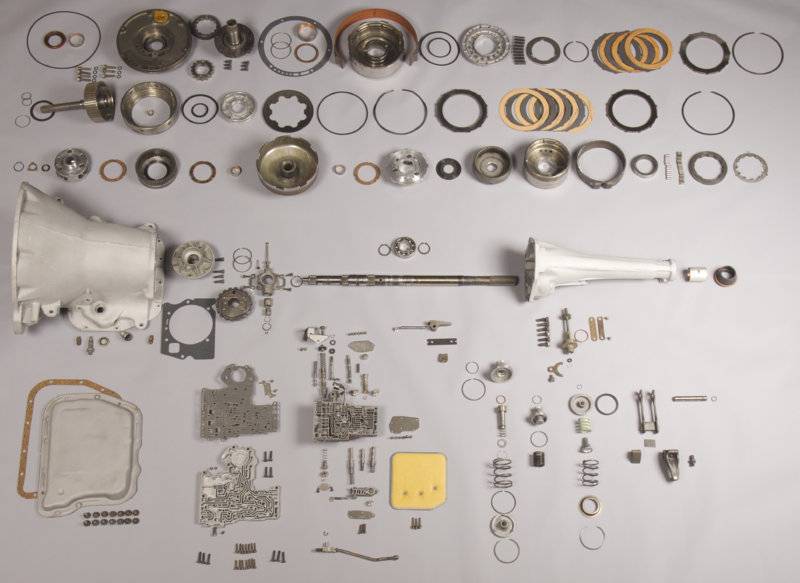

This book will also help explain a lot of things you'll wonder about while tearing it down.:)
