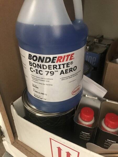

Looking for some guidance. I’m trying to do everything correctly but I feel like somethings not right. I have my panels down to bare metal. they’ve been sitting for a while so there’s a little bit of rust here in there. I got this BONDERITE C-IC-79 AERO stuff from the paint store that is supposed to metal etch and remove dirt/oil/corrosion. I put it on And washed it off with water like it says to. now my whole panel is turning orange. Is this normal? Do I even need to do this? I’m thinking about just sanding down some of the light surface rust areas and then coating the panel with the corroseal rust converter I have and then primer it. any guidance would be greatly appreciated.

I got all of the paint/primer/clearcoat from the same paint shop. They are the ones that gave me the bond right stuff as well. I just used it on my doors and wiped it off and they’re orange now so I’m wondering if that’s rust or what.
We use the bondrite etch wipes at my shop. Amazing product. What you have there is a variation of the same product for large areas. The Orange after applying the bondrite is not rust, it's part of chemical reaction of the etching properties of the product.
The surface rust should have been cleaned off before you put the etch wash on. You can still remove it but I would etch the metal again. Then apply your primer or epoxy right away. The etch wash does not have any anti corrosive properties and your parts will continue to flash rust until they are sealed with a prkmer or epoxy. Be careful if using epoxy , some companies don't recommend an etching product under the epoxy.

I stand corrected the bondrite cic79 has corrosion REMOVAL properties. SO if there was some flash rust this should have removed it for you. Leaving the metal clean and etched for your primer.

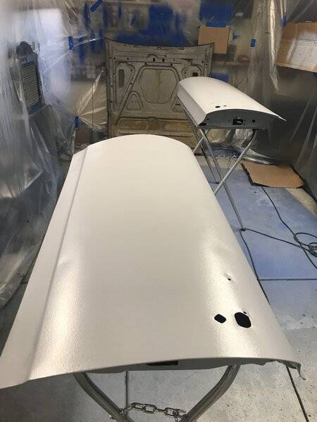

Thank you. I appreciate your knowledge on this. I sanded the doors again with 80 grit and used high build Vibrance epoxy primer on them. Now to dry and then skim coat and block sand.the hood is next.
