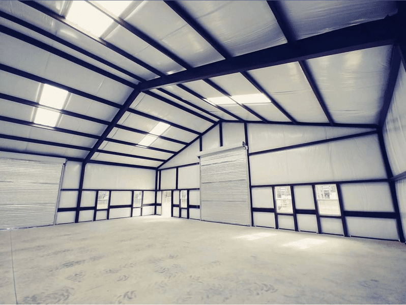

I'm planning on:
  1. Metal
  2. 14' wall
  3. 40' wide minimum
  4. 60' long
  5. Hurricane rated 125 mph. Open span inside. See pic below.
  6. Steel reinforced concrete slab
  7. 3,000 psi concrete
  8. 4" thick except thicker around perimeter and piers.
  9. Insulated film (forget what the e stuff is called)
  10. No electric
  11. No plumbing
  12. Doors & windows extra.

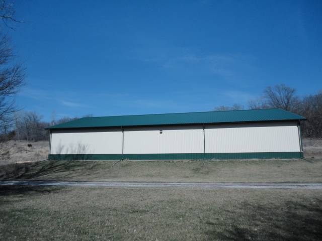

I built metal, with aircraft hanger insulation. Warm, dry and quiet enough
I built a 70x120 with 16 tall walls, 5/12 pitch, which the peak sits at 24 feet at the very top. with the the 16 ft sides I could make the building a two story if desired. The building was built by Astro
I did wood 6x6(every seven feet)
frame with aluminum siding.26 mil,,,,16 years and has not moved an inch. I did wood frame because in nebr wood frame is taxed at 30% of value. Steel frame is 90% of value.
That should get you over 30 feet at the center with a 5-12 pitch. A 3-12 pitch would get you about 24 feet at the center.

My 26 x 48 shop is attached to the house. 2 x 6 frame construction, clad with pre-finished wood siding to match the house. Inside I finished the walls and ceiling in metal siding. Makes it very easy to surface run all electrical in conduit and also a bit of fire resistance. Industrial chic look.
I am finishing up my garage build now. I went with a pole barn, steel over wood. I hung a steel ceiling in it. Ceiling's 16ft high, having blow in insulation done on top. Running 2x4 up walls between the posts, putting roll out R16 between boards covering with drywall. I would never work in an unfinished garage. So far, floor is concrete and painted polyasperic, ceiling is almost finished, LED 8 ft lights in, all wiring is done and power connected to the shop.
It's 60x64x16, so far I have nearly 85k in it. And it's not done. It'll be a few years before I can afford to do my rooms inside. Economy and prices suck.

That bubble insulation lasts about 10-15 years. I have that in my.shop. The tape used degrades, however, and you'll start to see bits come off the wall after a time. I intend to have foam used on the sidewalls this Fall, to replace that bubble stuff.
