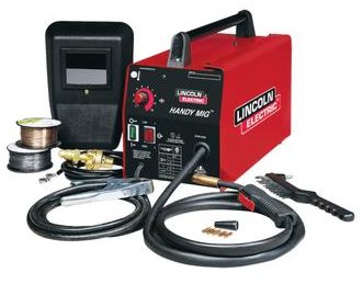

I was hoping to get an opinion or two or some help selecting a mig welder. I'm thinking that next month I'm going to purchase a new or used mig welder to start working on patch panels for the Satellite. The only things I can see myself welding on at home would be body panels and other light weight stuff for play and repair. For a fairly beginner welder, would I be happy with a Lincoln Handy Mig 110 welder? It comes in a kit with the gas regulator and tips for mig welding. I guess I just want something practical that I'm not limited to service with. Let me know if you think it would be a good choice or should I go a little bigger. I also am keeping an eye on local classifieds since you can occasionally get a good deal.... I just BARELY missed out on a three year old Lincoln 140 w/ cart for $150 yesterday. Crap!

Lincolns are good. The problem with that handy mig is it only does flux wire, too dirty for auto work. You need the Lincoln 140HD or the 180 HD, both use gas, which is what you want to use. The 140 is 120V whiule the 180 is 220V. Home Depot sells them for $524 and $669. There is an Ebay listing for the 140 at $519 free shipping, if it's out of state you'll also avoid sale tax
My mistake, that handy mig does do both gas and flux. I would still recommend the 140 if you have to go 120V but the 180 if 220V is not a problem
