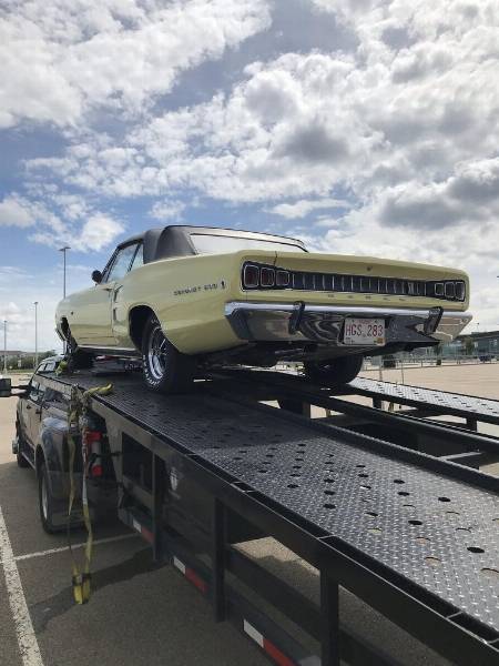

When I was out visiting Wally and the coronet in Newfoundland we discussed transport and he said he would do all the leg work on his end since he has had cars and equipment moved all over Canada and knew a bunch of good people. So after a couple weeks I get home from work early one morning, I work nights, and a text comes through that I have to call this guy ASAP because they want to pick up the car that day! So I make the call, discuss the move and price and then send him the payment, car got picked up June 08 and was on it's journey west!

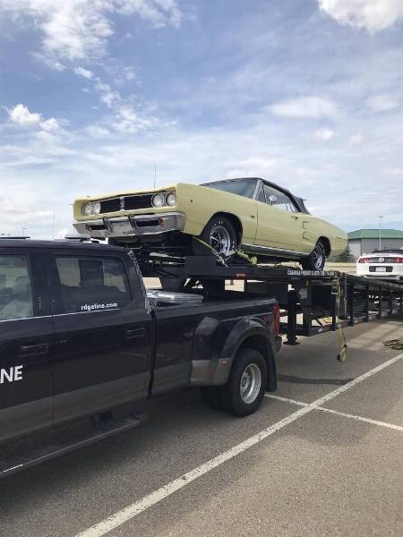

We worked out the move was only going to come to Edmonton Alberta, since they wanted a $1000 more to bring it BC and there were more back hauls in Alberta as well, so I said I would meet them in Edmonton and bring it back to BC myself for the final leg of the transport. So get the call on June 18th that the driver should be in Edmonton next day or so...he had a non runner on the back that they had to bring in a loader to get off so was delayed 8 hours...finally I get the call that I need to be in Edmonton June 19th between 12:00 to 13:00. So I left my place at 02:30 and arrived there at 12:30...I had only managed to get 2 hours of sleep before going..:(
Jarrid was the young fellow who brought the car across the country for me, super nice guy and he absolutely loved the car and thanked me many time for allowing him to transport it for me...

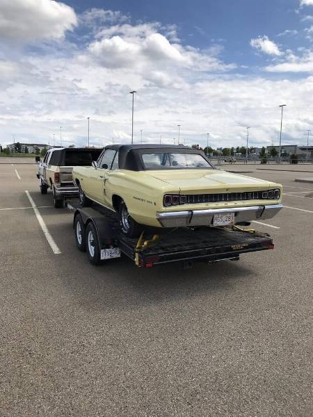

Got it loaded on my trailer...

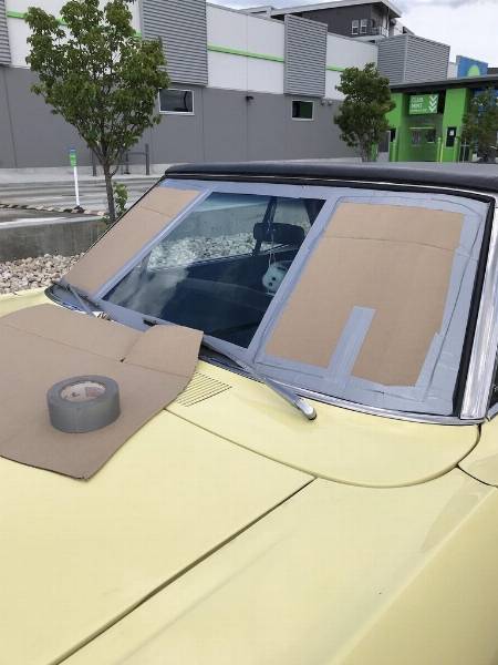

....and then had to find the one and only tire shop open on a Sunday in Edmonton since one of the tires on my trailer had decided to de-laminate during the 8+hr drive and the outside half of the tire was bulging and had worn off all the tread. I ended up getting 2 tires since I wanted a matching set on the rear axle. Once the trailer was back up and ready to go I decided that I wanted to tape cardboard to the windshield to protect from rocks and debris hitting and damaging it.

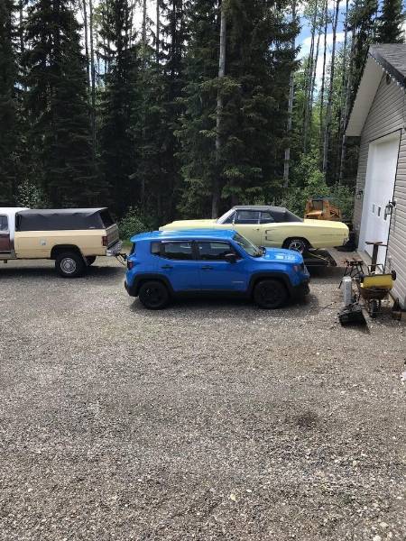

Just before entering Jasper National Park....
Got home about 01:45 and just parked in front of the shop and came inside and went to bed...I'd been awake 24+hrs and drove 1700+Km's on 2 hours of sleep....I was pretty darn tired!
Snapped this when I got up...
My ramps were to short and the mufflers were going to get damaged so I had to get creative....

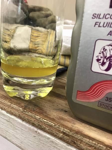

When coming off the transport truck the coronet had barely any brakes...just a spot at the very bottom where they would kind of grab. So I assumed the MC had died over the last 20 years and would need a new one....popped open the MC and found the rear reservoir empty and just a little bit in the front.
I couldn't remember if I had used DOT 3 or Dot 5 in the coronet...so I went online and found a quick method of determining which one I had. used a syringe to pull out a bit of the fluid and put it in a clear glass cup, then add a bit of water...if it mixes you have DOT 3, 4, 5.1 Glycol based fluid, if it stays separated then you have DOT 5....I had put DOT 5 in.
And after a little digging I found three new and sealed DOT 5 containers that I had purchased for the Coronet 20+ years ago! I couldn't believe I still had them!
I topped up the reservoirs and pumped them a bunch and started to get some pedal again but will have to bleed the system.
