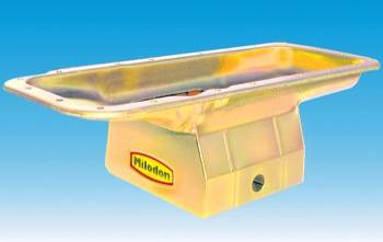

I got this pan:

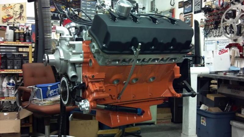

This is the pickup kit I used to overcome the angled mounting.
http://www.summitracing.com/parts/mor-24840?seid=srese1&gclid=CIvb1N_ezb0CFQ5gMgodJiMA2A
I used a Moroso inline filter too. It's just a bit of extra insurance.

I got this pan:

I got this pan:
That looks to be the correct pan for your set up. My Milodon 7 qt pan has tapered sides all the way to the bottom. So an external pick up would not work on my pan. But I am using the internal pick up. Nice that yours is vertical at the bottom. And looks like it has the hole there for your external pick up line. I don't think you will have any probs putting that cover on your Melling pump.
