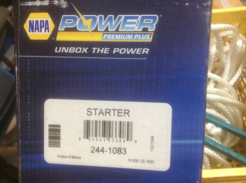

Put one of these in in my Satellite. You need to remove a plastic cover to get to a second set of terminals, no big deal. $60 5 years ago. It's a mini starter.
92 – 95 Dodge P/Us with 3.9L, 5.2L, and 5.9L engines

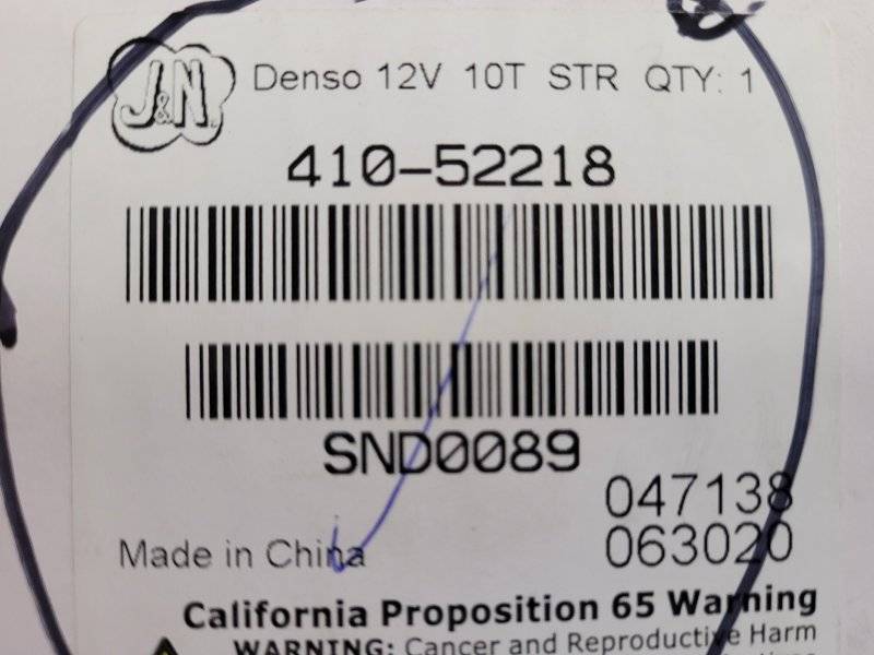

For next time / next guy. Bought this off of Amazon for around 50 canuck bucks to put on the 340 Swinger and was identical to what I took off of it. Then the starter died on the 64 and I put the old one on it's 440.
Do you have a link to that starter? When I type 410-52218 into Amazon the cheapest is $123 for me.
I'll have to dig back though my Amazon account I guess. It was an anomaly when I found it so cheap, didn't even think it would work.. LOL Just googled it and everywhere looks like stupid money now..
Looks like I didn't buy it on Amazon... maybe direct with a supplier. I'll have to dig through my Dart paperwork tomorrow...
