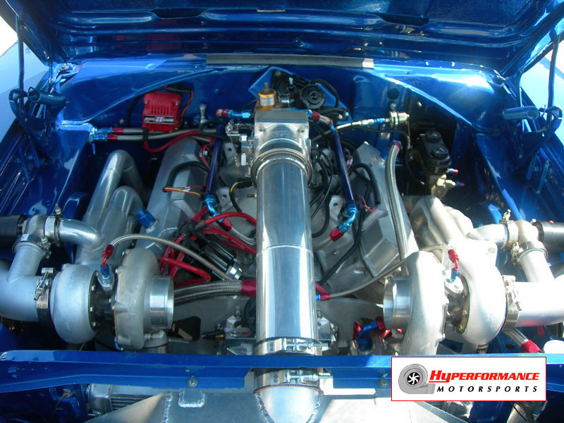

Do any of you guys have pictures of your turbo set up with a BBM? I know I am going to have troruble fitting everything in.
Nothing I have is going to help you any. My turbos will be under the front fenders, the intercoolers will be in the nose, and there won't be a ton of stuff under the hood. If I was doing a wedge in a regular B body, I'd look at copying Bo Peebles charger. Nicely done.

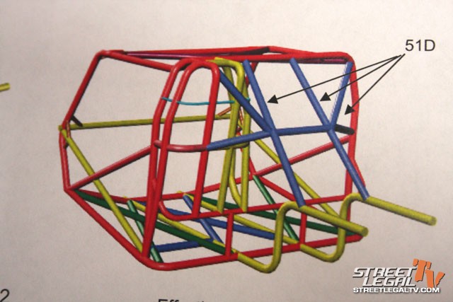

Sounds good Goon. What are you guys doing for subframe connectors? Weld in or bolt on?
I did weld in connectors on my Charger and added bracing to the front end. U.S. Car tool makes a good kit for frame stiffening.Bolt in connectors work great but your going to be doing a lot of welding anyway so it would probably be just as easy for you to get the weld in.
I used the US car tool connectors in my green car and then added a 6pt bar. We've still flexed it hard on the track due to the weight. My black car is getting an SFI 25.3 (minus the funny car cage part for now) so I'm not even going to bother with subframe connectors.

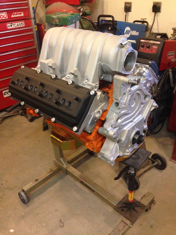

Here is a 5.7 with 6.1 top end that I built. I am considering doing twin turbos on this one.I am putting this engine in a 67 barracuda.I love big blocks too but when I built this I realized that these Hemis are really awesome motors.

I did the 5.7 because blocks are more available. If you buy a non running 5.7 the heads are usually warped. For me I just want the block. ( I paid 200.00 for my block and have a spare that I bought for a 100.00 dollars)
The stock 5.7 rotating assembly is maxed out around 450 Hp Reliable. What I did to save money was I bought a used low miles 6.1 Crankshaft ( there factory forged steel same stroke and journal size as 5.7) Wiseco makes stock 5.7 bore forged pistons (Comes with rings)and Scat industries makes stock 4340 forged rods( press in pins though).
Crankshaft=400.00
Pistons= 700.00
Rods= 400.00
So for 1500.00 I have an all forged rotating assembly that will handle up to 600 - 700 HP Reliable. The 392 Stroker kit is about 2600.00
The heads are reasonable. I bought my 6.1 CNC ported heads with upgraded springs new for 2500.00( there both right heads and one was converted to a left)
There are things about these motors that in my opinion are musts.
The head bolts are torque to yield so the block should have heads studs. And the mains should be changed to studs as well.
I do the same things when I build a Big block. The down side is there isn't a lot of aftermarket support. But its starting to come around.The up side is the factory stuff accepts performance like the LS motors.
