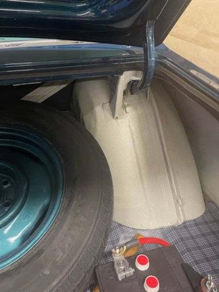

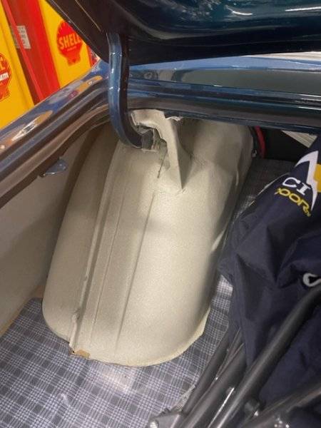

I bought a 64 that has been mini tubbed. It was a great job. Let me know if you need any more pictures.

I assume that you will have your deck lid off while doing the mini tubs( the weight of the deck lid is what stresses this area) so it will be fine without adding support during the work. I was ready to brace mine when I mini tubbed my 64' Polara but honestly saw no need to after i cut the feet loose from the top of the wheel tub.
