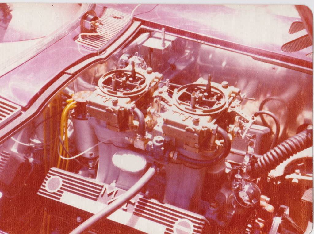

Go with the tunnel ram if that's the look YOU want. A cam designed to work with your 3,000 rpm stall converter and 727, combined with some lower rear end gears (think 3:91 or lower) will work fine with some tuning. There are a lot of nay sayers out there who have never run these combinations.... Here's my ticket to the club:
