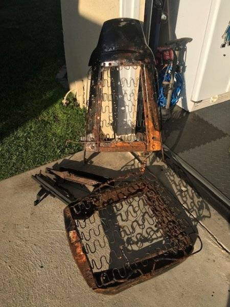

I agree! I didn’t want to spend the $$$ for sand blasting, so I had used Molasses and water on my two bucket seats and back seat. I built a wood frame box and lined it with thick plastic. Then, I power washed them, powder coated the bucket seats and por15 the rear seat. Of course then my project ran from then on as slow as molasses!

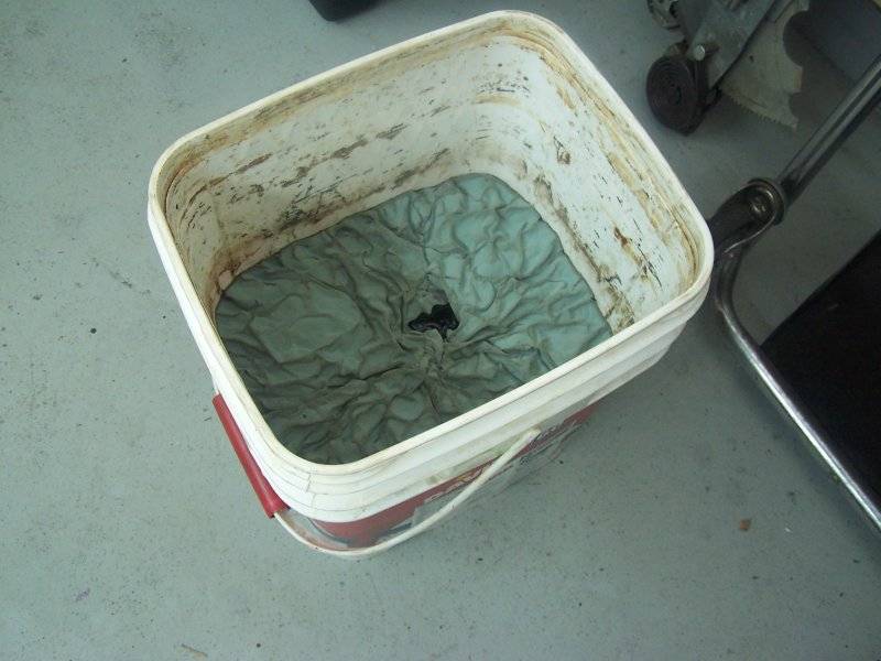

I’m talking about an engine that has been wet insode, with pitted bores and corroded pistons. The kind that people pound out with a BFH. Those don’t free up with oil or lube, the bores have high spots from the pitting.
don’t be like this man,
Hole in cylinder wall.

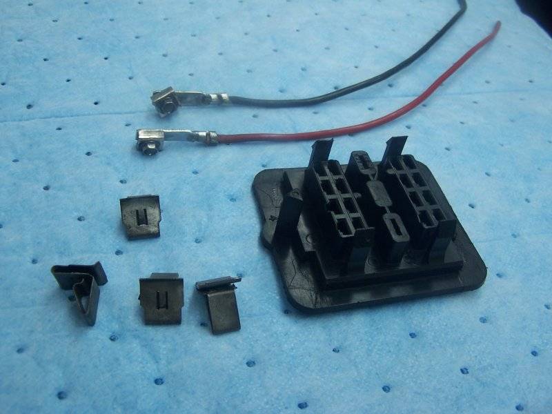

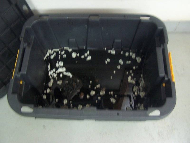

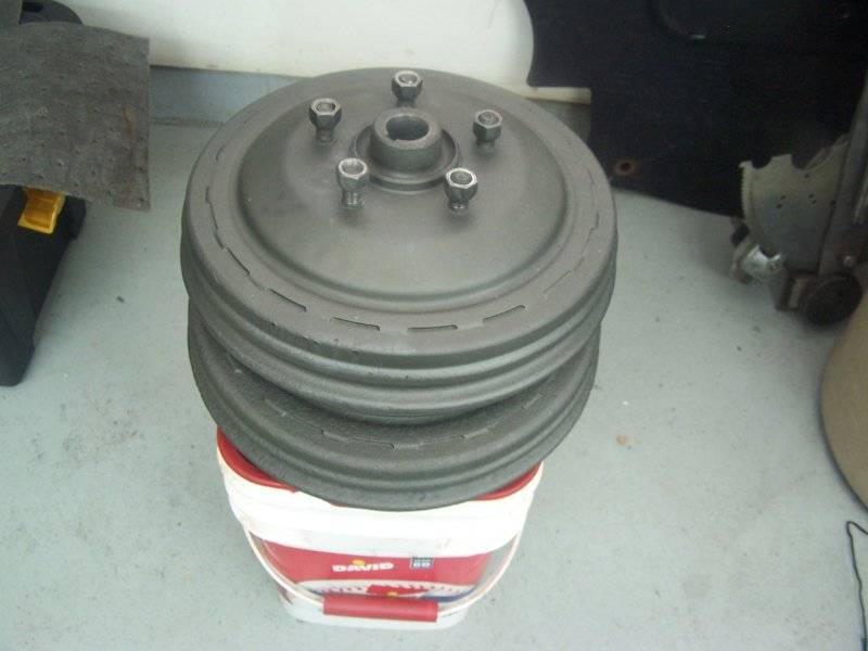

I have been using the molasses concoction for years. As others have said, it won't touch grease but works wonders on rusty iron and tin. I have a couple containers I use constantly. One is a 6 gallon bucket and the other is a 20 gallon tote. I like to keep them covered since the odor can get pretty intense. I use a 7-1 ratio to start and add some water from time to time when it gets low. I usually let things soak for at least a couple weeks then rinse them with water and hit it with a wire brush. If still crusty, I toss em back in the bath. Seems like I always find a coat of mold on top than I skim off first. I replace the mixture once a year or so. Here are some pics of items I did recently. Someone was asking about doing a bulkhead connector. I included a couple pics of one I did. The unattainable drums, I sprayed with Eastwoods Cast Blast and the Tin parts with Eastwoods Bare metal paint. The blue stuff in the one bucket is the mold that forms on top.

How did I never hear of this before? Thanks for sharing guys! Wow, those drums are sicko clean!

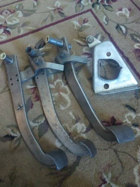

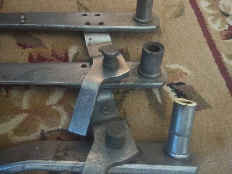

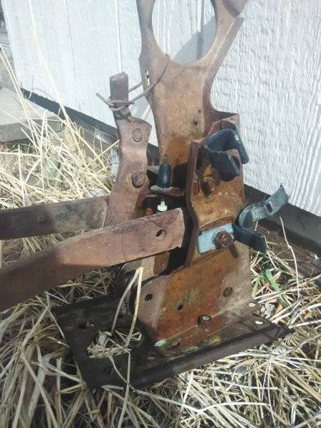

Here are a few pics before and after 1 week in the molasses. Hit them with a little soapy water and stainless steel scrub brush then dried them off quickly with a towel and hair dryer. Pretty good results.
Looks good to me......When I get them cleaned up good, I paint the bare metal stuff with Eastwoods bare metal gray and the pedals with a semi gloss Chassis black. Never have to deal with em again.
