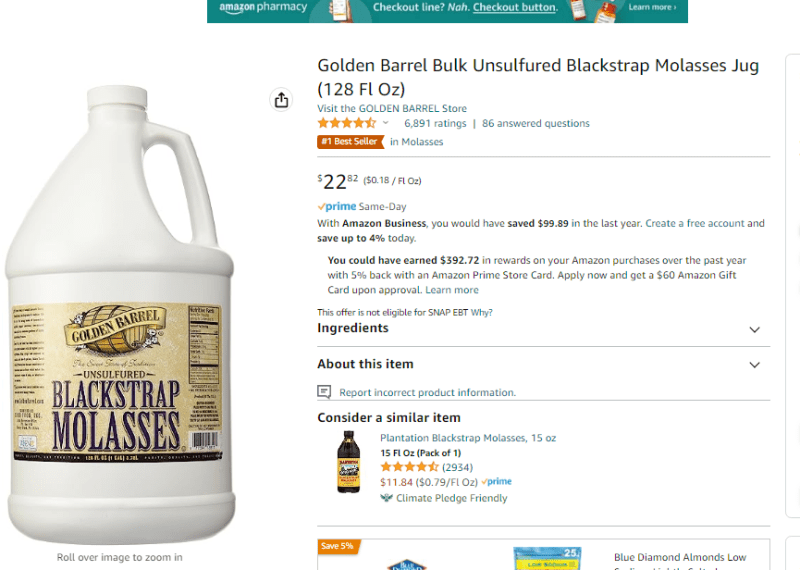

Went to my local TS yesterday only to find they don't stock it around here. Not really surprised. The closer you get to San Francisco, the harder it is to find anything useful. I went on their website and could only find Black Ops Molasses liquid that they sell as an deer bait. I couldn't find a list of ingredients for that, but they talk about it being proprietary, which makes me think it isn't straight molasses. Might hit up the local feed store today. Can you post what you find when you get to TS?<<<<<<<< heading to Tractor Supply
These two are available locally. Are they high enough octane to do the job?
https://www.googleadservices.com/pa...jIkEHUH_B5EQzzkoAHoECAUQCw&nis=2&dct=1&adurl=
https://www.googleadservices.com/pa...vIaKgIv-AhVwjIkEHUH_B5EQwg8oAHoECAUQKQ&adurl=
I wouldn't bother with those little gallon sizes, it's cheaper in volume. Isn't there any sort of equine or feed store in your state? Look for a pail like this, which would cost me about $30 (CDN) for 5 gallons.These two are available locally. Are they high enough octane to do the job?
