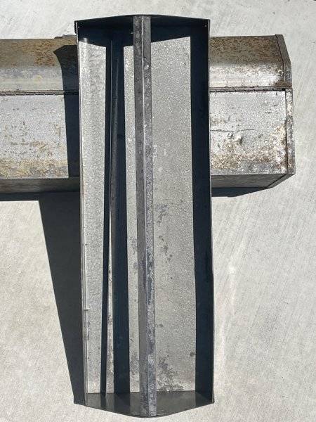

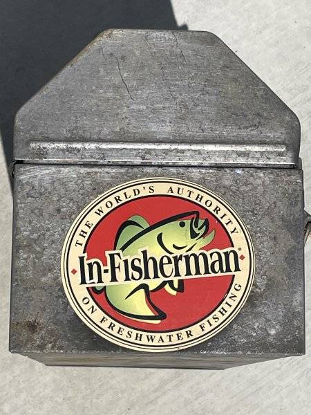

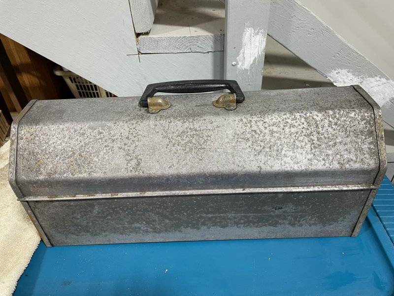

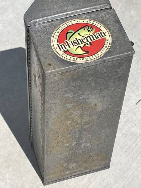

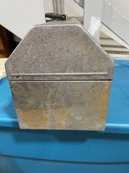

The chrome on the latches were in poor condition and the fishing patch certainly is a wild card, that’s the scientific description meaning “I don’t have a clue how the molasses will react to the glue and material of the sticker.”.
Here’s a look a few weeks later;)
As the pictures show the sticker is still present and firmly attached.
The whole toolbox went back in the drink for another few weeks, a calculated and precise timeline.
A scrubbing pad was utilized to knock off the loose particles between soakings and what is the end result. Is the fishing sticker still attached?? What about the paint/galvanized coating, was that affected?
Stay tuned!
Conclusion: The fishing sticker is still strongly & strangely holding up, soaking it longer may have discolored it or brought minor rust back, the paint/galvanizing was loosed/bubbled some but that helped with scrubbing it off, it took most of the rust off the chrome latches.

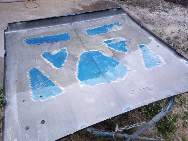

so a little bit of a learning curve I had forgot to mention.....
when doing large parts like the hood skin above........ I built a custom box, it could have been a little more accurate; but it was made out of scraps and was lucky to piece it together....... I filled extra space and voids with wood and figured it might hold 10 gallons. I was way off......
tip: calculate cubic inches and convert it to gallons...... I calculated 27 gallons, and guess how much it held? yup, 27 gallons........3 of which are molasses, 75 bucks.......... I will drain my box and use the solution for other things
roll of 6 mill plastic was 40 bucks, yikes........ I lined the box with it and pulled a tight layer over the top to seal out bugs and stuff
if I had to buy sheet of OSB and some 1X3s ect, probably would have been another 30-40 bucks
if it cleans this skin as advertised, it was worth it I suppose....... since I can reuse my 75 dollars worth of molasses
next time I'll have a clue........ and a plan

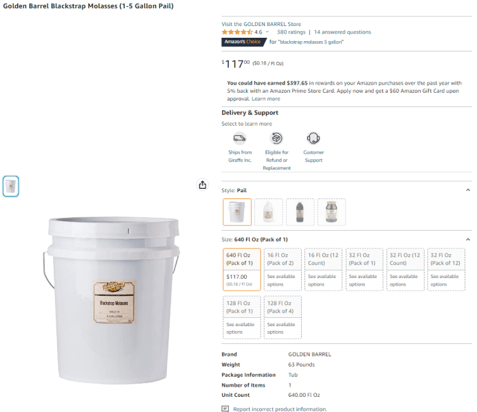

so what is the difference between these?.......is the cheaper stuff just as effective? is it diluted?

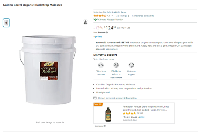

Your prices for molasses are a lot higher than I pay. I can get a 5 gallon pail for about $30 Canadian. (I haven't actually checked this year, I'll let you know if it has gone up since my last pail).
heres another one....... this is the stuff I used, but thought I'd only need a gallon lmao, hardly any savings buying the 5 gal, like 8 bucks

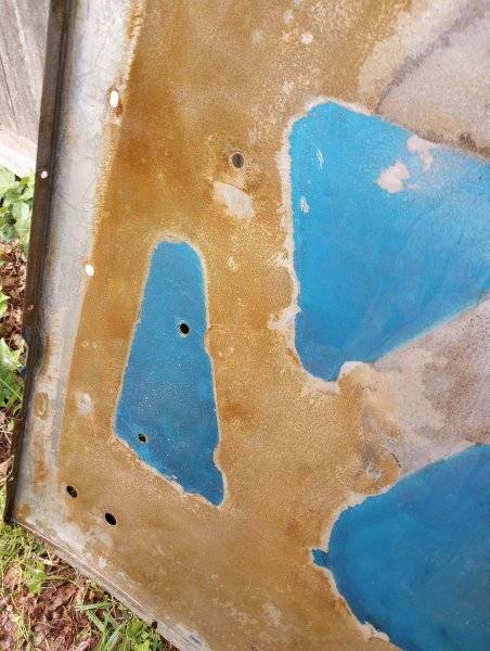

don't let the orange tinge fool ya, this thing was nasty, now it's clean.......the molasses is impressive to say the least...... I'll treat it with some ospho and epoxy prime this baby; it'll never rust again
wow.......wetting it with ospho instantly finishes the job......we really may be onto something here :thankyou:
Forgot to put in that I got the pail for $29.99 again in Auguast. I had this picture in my own molasses thread but here it is.

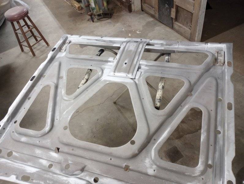

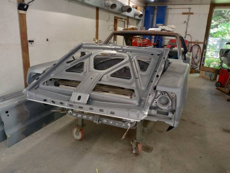

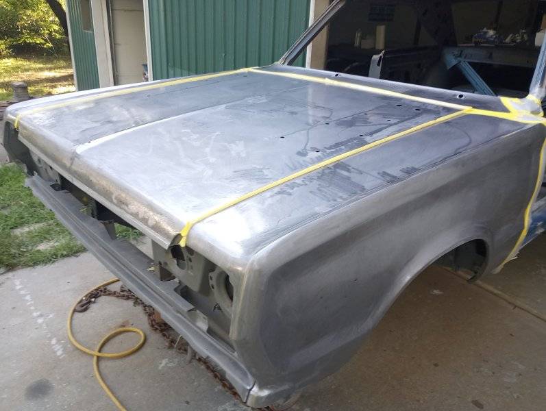

the hood is back in one piece, I sand blasted the frame and epoxied everything........ I also used ospho to clean up the topside of the hood and fenders
