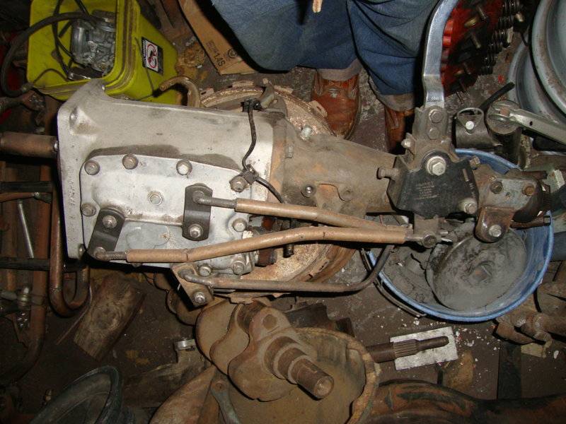

this is an od 4psd from a pickup . there not as strong gear wise as the older a833 4spd's . and most have the double tail stock shifter mounting like 70 up b/e bodies . this one i made a adapter to fit it in an a body .
If its from a truck it won't have the rear shifter mounting point drilled and tapped.

i've had them both ways tapped and untapped . they came in vans as well as the p/us . oh and the shift plates are not the desired one as well , 69 back is the better of them . so its a lighter case , but there is some work to be done to put earlier gears in them . of course if your a lucky son of a gun . you might just find a all alum cased b/e hemi gear box .
i've had them both ways tapped and untapped . they came in vans as well as the p/us . oh and the shift plates are not the desired one as well , 69 back is the better of them . so its a lighter case , but there is some work to be done to put earlier gears in them . of course if your a lucky son of a gun . you might just find a all alum cased b/e hemi gear box . View attachment 581152

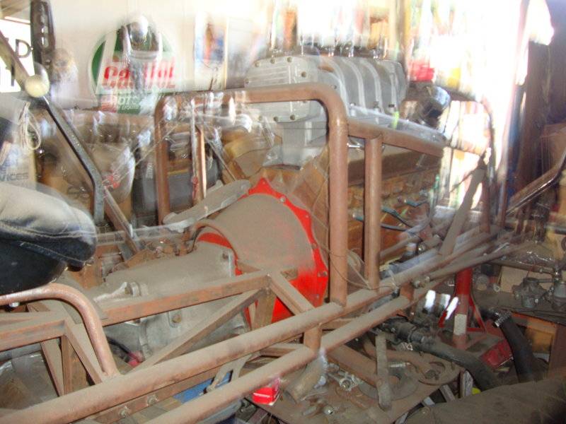

What praytell do you have in that picture??
thats a street roadster 27 t turtle deck altered , with a 6-71 blower on that wedge in it , but i'm swapping it out for an old school early hemi and its got an 8-71 blower n hilborn four port injection on it . i'm still keeping that slick shifter hemi a833 trans behind it . should be a fun ride , don't ya think . lol .
thats a street roadster 27 t turtle deck altered , with a 6-71 blower on that wedge in it , but i'm swapping it out for an old school early hemi and its got an 8-71 blower n hilborn four port injection on it . i'm still keeping that slick shifter hemi a833 trans behind it . should be a fun ride , don't ya think . lol . View attachment 581185 View attachment 581186
