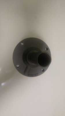

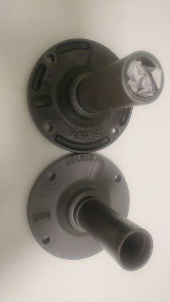

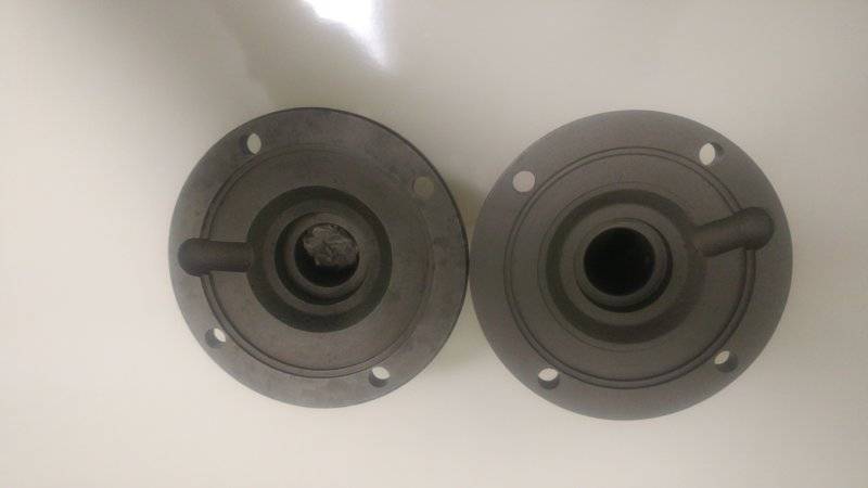

Here is 2 bearing retainers. One is an original from a 70 up BB A833. Has the larger bearing cut out (308) and the 4.16" bolt pattern. The second one is the standard bearing retainer from an OD Truck. It started as 5.125" OD but with the same 4.16" bolt spacing. It was cut down to 4.8" and is a match now for the original piece. The middle picture has them stacked on each other so you can see the hole line up.
Ignore the fact that the original is sleeved for a hemi large throwout bearing.
