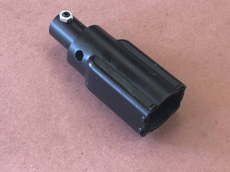

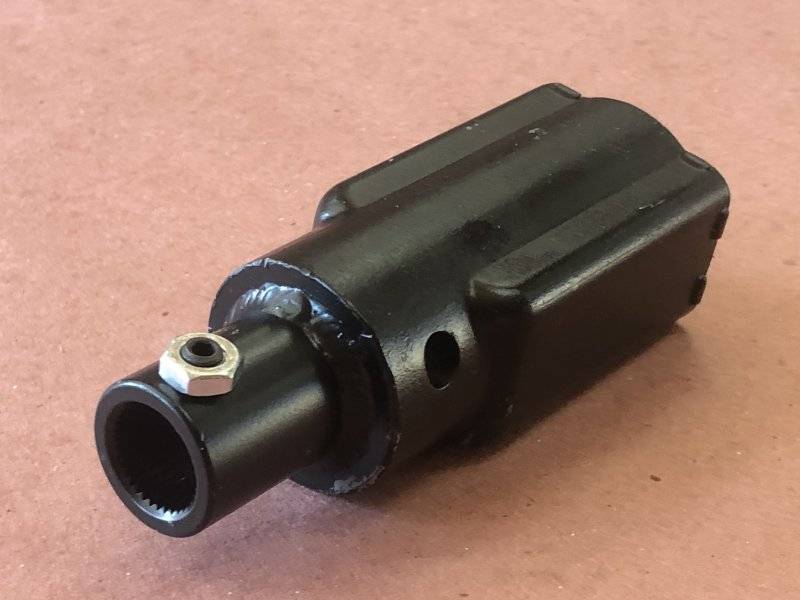

Used the adapter kits for the column and they have always come apart on me and spread grease everywhere.

How could a one piece adapter come apart?
I guess some are at more of an angle than others but the grease retention is no worse than stock. Sometimes the inner and outer shafts slip within each other some, effectively making the shaft shorter and the shoes in the coupler engage closer to the grease seal and thin retainer. There are wire clips to help the thin retainer stay in place. I think the thin steel retainer is a flimsy design so the wire clip is an excellent idea.
