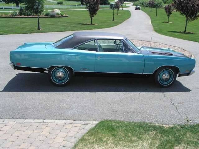

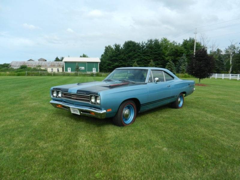

Far as I know, gear ratios were 3.54 or 4.10 with the Dana.. Track Pak (3.54) OR Super Trak Pak (4.10)
