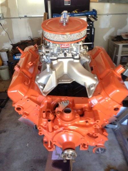

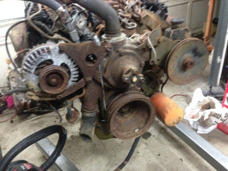

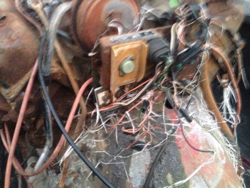

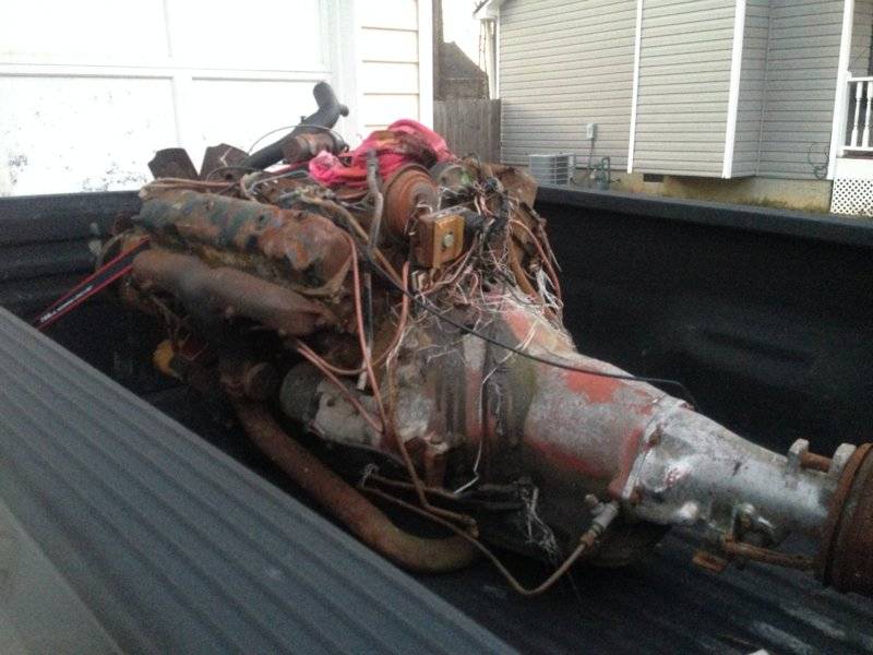

I paid 250 for mine.. It looked like a bush baby and it was sitting on a trailer in a field for 20 years the guy said.
I have one just like it, 77 RV motor in my 70 Dart. Runs good, quiet, idles very smooth. 452 heads, cast crank, mild cam. Pulls fairly good, and has very little leakdown. As stated before, these motors don't typically see alot of miles, racing, or high RPM. You can put in some quench dome pistons, a little hotter cam, aluminum intake, and get the C Ratio up to around 10.5 and see some good power. A little head work on the 452s goes a long way. Your trans is likely a heavy duty unit, but the rods are prob not the 6 pack type. Would be interesting if they are. Yes, buy it! Putting a torque bar & socket on the damper bolt to make sure it rotates freely, is a good idea.

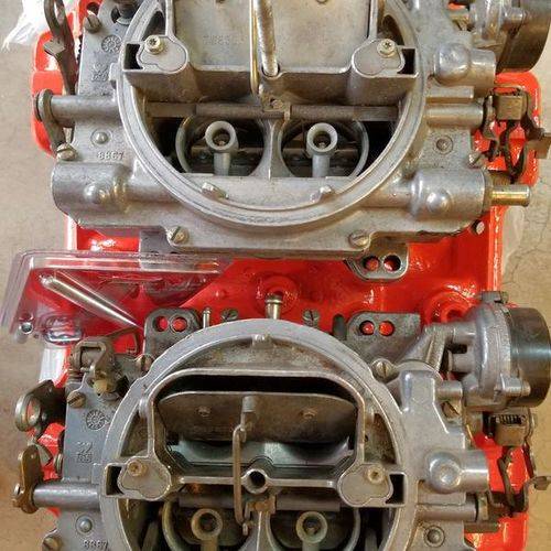

Anyone interested in a dual quad cast iron 440 intake ?
Is that a dual plane intake?
Not sure but I'm assuming it's dual plane. The guys about 40 miles from me so If there's and interest I can go put a eyeball on it. The picture is from the ad I found.

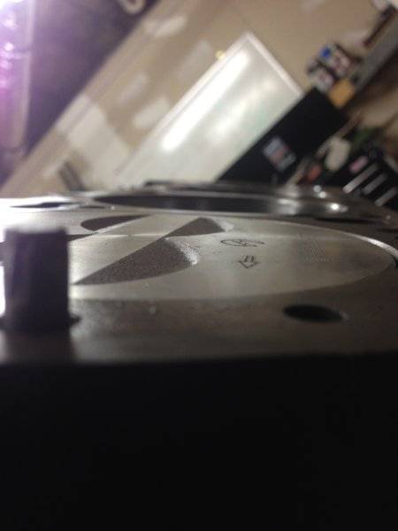

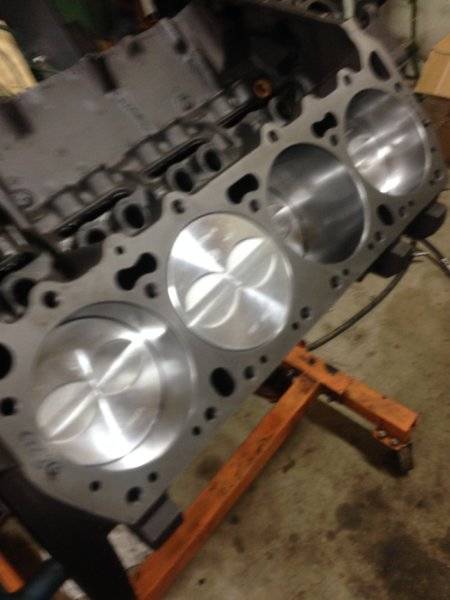

I wish I knew of a place around here that I could get to dyno my engine. I'm interested to see what the numbers are.. Maybe someone here can estimate. I was told one number by the machinist. I don't believe it will be any where near what he said. I will refrain from posting that number so I don't look like a moron.
But if this picture is any indication... Maybe hes correct. This is at TDC its .005 in the hole.

I'm assuming the top picture is what it looks like now. Haha. That's a good start. Power is determined by alot of things, the most important being good cyl head airflow. So put some good heads on there, a decent cam, headers etc, drop it in a car and run it down the 1/4 mile. Then you can use a calculator to get an idea of horsepower.
And the $500 you save on the dyno run, can be spent on the motor.

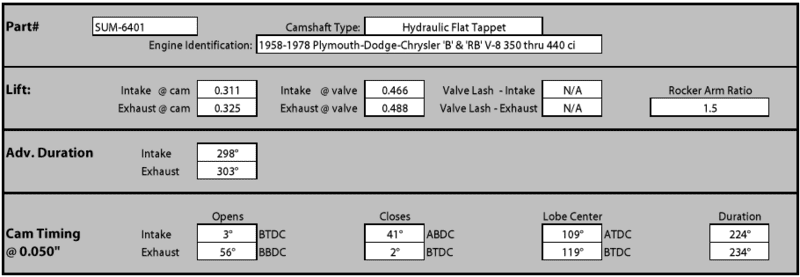

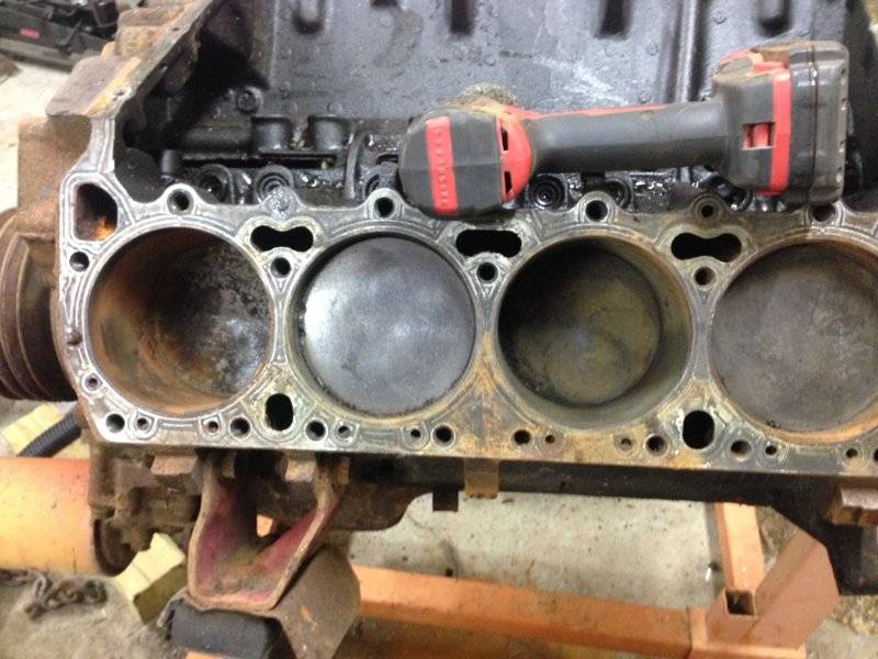

It has 452 heads they had some bowl work. The cam is a Summit K6401 cam. I calculated the compression ratio to be 9:64.1 with .039 head gaskets. This is the cam card. I also have a mopar M1 single plane intake. Speed-Pro Forged Pistons L-2355F 30 I have a build thread somewhere on here.. There is a lot of info in that thread for making power with these old RV engines. Hughes makes a cam and lifter setup just for the RV engines.
Here is my thread on the 440 build. Mine was trashed and needed a rebuild anyhow. https://www.forbbodiesonly.com/moparforum/threads/picked-up-a-low-mile-440-today.143842/

Wonder if a Thermo Quad is worth rebuilding?
