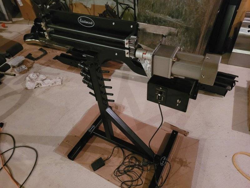

I recently motorized my Eastwood bead roller using mostly off-the-shelf components from Amazon. The only thing I had to fabricate was the brackets to hold the junction box and motor. Out of pocket was just under $200 counting everything. Probably used another $20 worth of steel to make the brackets. It works perfectly and I am very happy with it.
Eastwood normally sells their drive system for $487. It is currently on sale for $330. I would have probably bought one at the sale price.
AC motor. $126
18-25 mm servo coupler $26
Foot switch $10
Junction box $15
Toggle switch $10
Misc fasteners $8
Metal for brackets ~$20
It's an easy afternoon project. Motor I picked is probably overkill. You could go cheaper.
These are the main components I used if anybody wants to try something similar.
High Torque Electric AC Gear Motor Low Speed 15Rpm, Variable Speed Motor 110V 200W Output Shaft 18mm + Reversible Speed Governor​
https://www.amazon.com/gp/aw/d/B07XJB9MFL?psc=1&ref=ppx_pop_mob_b_asin_title
18 to 25mm Servo Stepper Motor Shaft Coupling, Aluminum Flexible Spider Coupling​
https://www.amazon.com/gp/aw/d/B0974BSYRJ?psc=1&ref=ppx_pop_mob_b_asin_title
Foot Switch Normally Off Press and Hold to ON 10FT UL Cable & Plug, Dead Man Pedal Momentary 15A 250VAC US 3-Prong​
https://www.amazon.com/gp/aw/d/B0BY4WVG3J?psc=1&ref=ppx_pop_mob_b_asin_title
Junction Box IP65 Waterproof ABS Plastic Electrical Project Case Power Junction Boxes, Project Box with Fixed Ear Black 7.87x4.72x4.45 inch (200 x 120 x113 mm)​
https://www.amazon.com/gp/aw/d/B0CQFYMLKG?psc=1&ref=ppx_pop_mob_b_asin_title
Twidec/3Pcs Heavy Duty Rocker Toggle Switch 16A 250V AC SPDT 2 Position 3 Pin ON/ON Switch with Metal Bat Waterproof Boot Cap Cover​
https://www.amazon.com/gp/aw/d/B07LBNK71S?psc=1&ref=ppx_pop_mob_b_asin_title
Floor stand is from Eastwood. Steel might have been better for the coupler, but the only ones I could find were a lot more expensive. The aluminum one seems to work fine.
