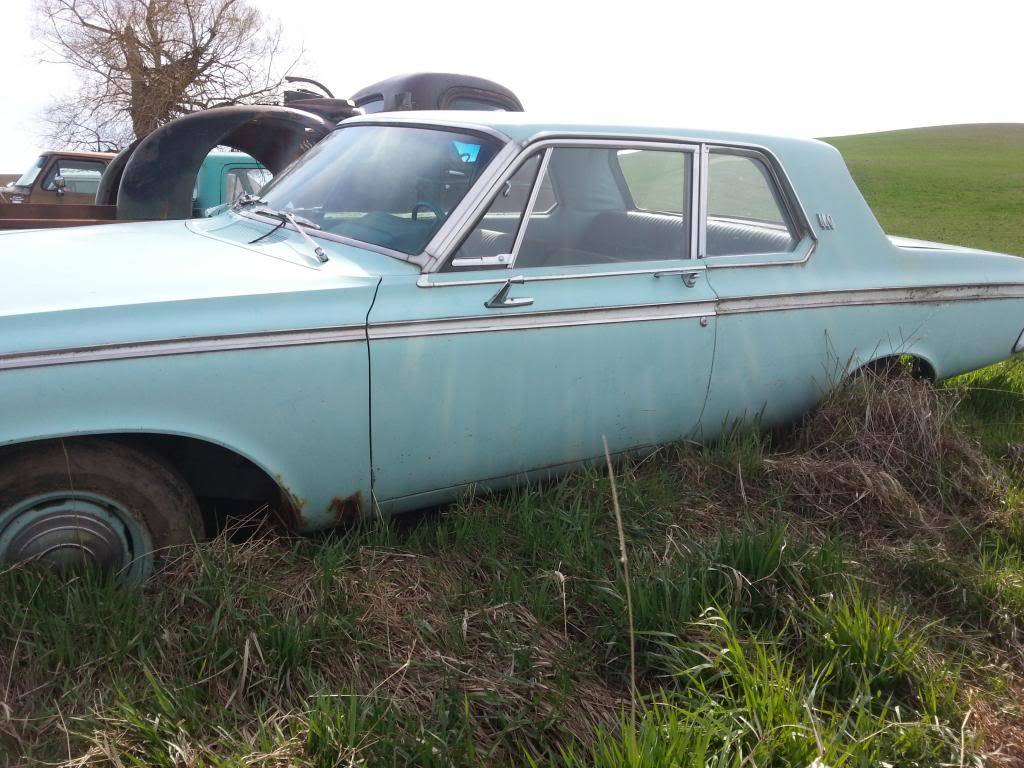

Here is how I found it,

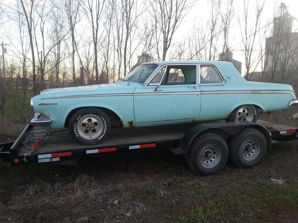

got it home on the trailer,

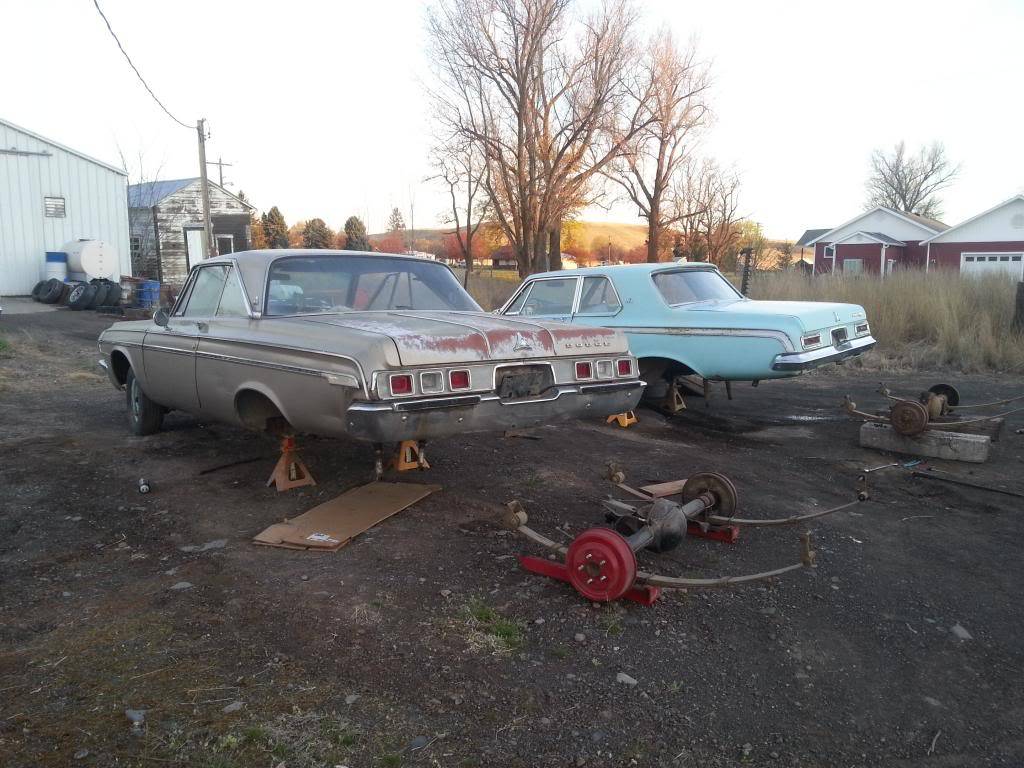

Now, in order to purchase the car, I had to sell my '64 polara. but, it had all my 4-speed parts, power brake set up, exhaust, and rearend. So the deal was made, but I had to pull all the parts, and make the 64 rollable.
I kept the rear end for a few reasons:
It already had 11x3 brakes, just redone. it was the newer style housing ('68), it had my 489 case 3:23 sure grip unit, and both cars sat the same level, however, the '63 had home made rear shackles, and the leaf springs where massively de-arched..
so first thing is first, strip all needed parts of the '64 and swap rearends (can't fit both cars in the shop, and there was a truck on the lift already.. )

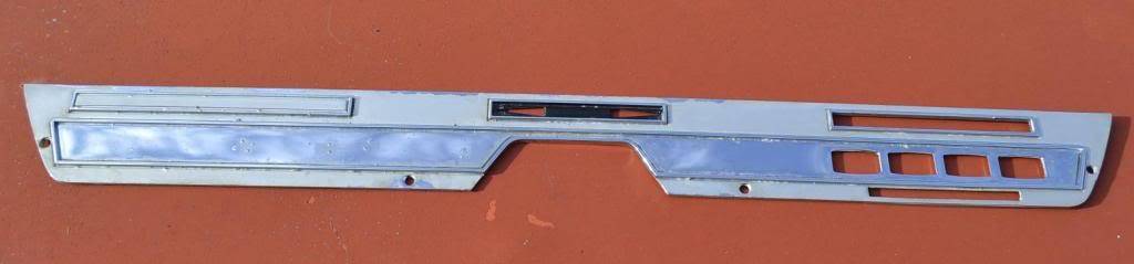

I scored my push button delete plate, now I need one piece of trim for the passenger door, and the little pieces that go inside the tail light lenses for the passengers side and should have everything else..
Nice 4 speed part pistol grip, I saw one the other week advertised as a shifter delete plate.... No it's a 4 speed cover plate lol
