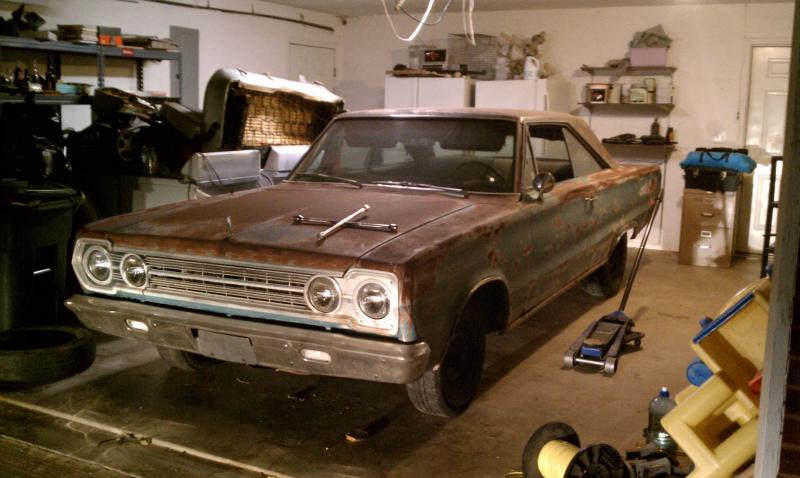

Good day everyone.
For those of you who remember me, about 3 months ago, I acquired this car with great excitement. After getting it home, I quickly become overwhelmed with the amount of rust on the car. I went through a time where I considered selling it, but I just couldnt bring myself to do it. Even as I look upon the rust and minor dents, I can't help but see the potential beauty and worthwhile hiding behind it.
SO, that having been said, I have decided to tackle the mountain of work ahead of me, one proverbial shovel-full at a time. After some more disassembly of the car, I'll be tackling the driver-side quarter panel.
To anyone who has replaced rusty quarters on a 66-67, please feel free to message me with tips and suggestions as this will be my first time to do something like this. I have an autobody guy who will help me, but I'll be doing alot by trial and error.
Thank you all for your time, and I welcome your thoughts. I will update with pics as I proceed with the quarter replacement sometime around new years.

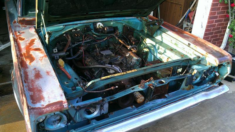

I got the Front end partially dismantled today, and pulled off all the accessories to the engine. Also I have all the seats and carpet out too. Slowly getting this car apart! I'm making financial plans to get the bodywork accomplished in the next 6 months. *fingers crossed*
Can anyone recommend any specific order to dismantling a car? I figured I'd start up front and work my way back.
Dismantling the front...
This was my first attempt on degreasing the engine.
I got alot of it off, and can see that the engine used to be blue! Still need to do it again. I also powerwashed the entire engine compartment.
She's slowly coming apart!

Show us the damage.
There are a couple repair panels out there, and at least one sucks (it's flat).
You might be able to use a patch from a 4 door.
