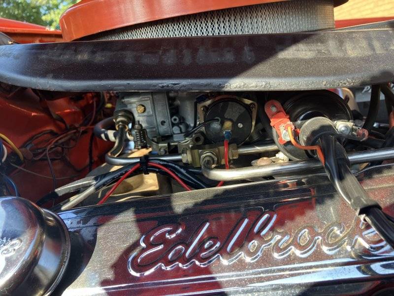

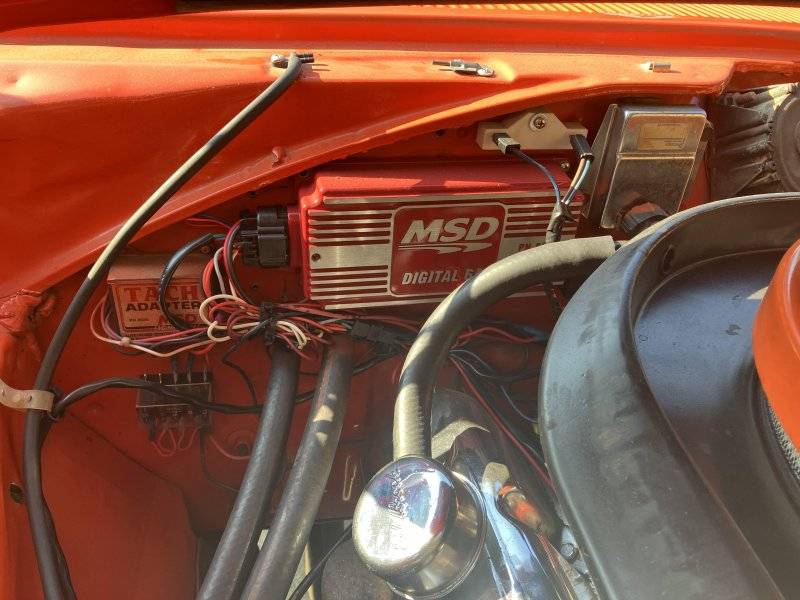

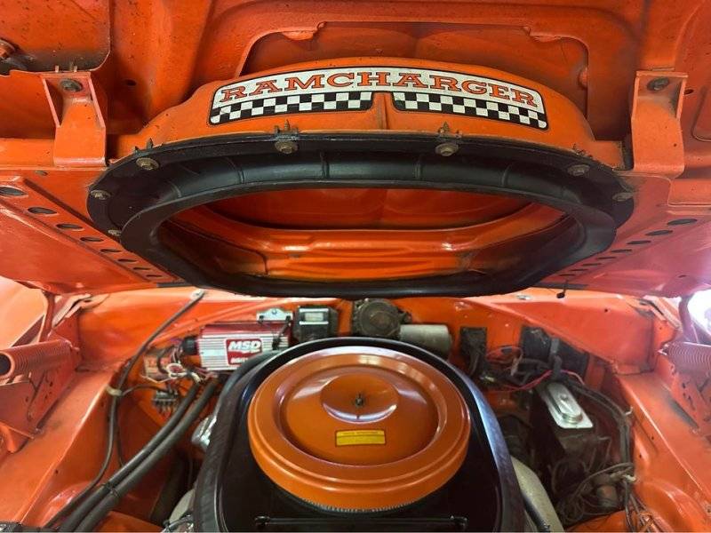

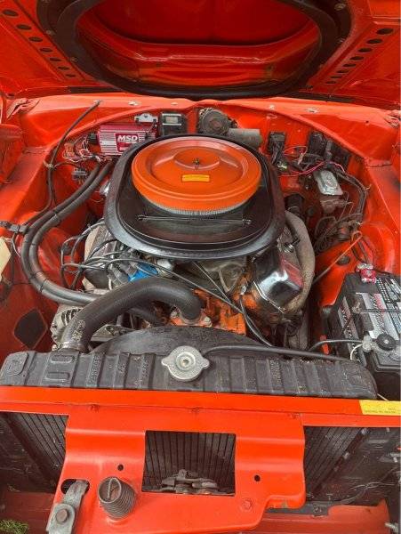

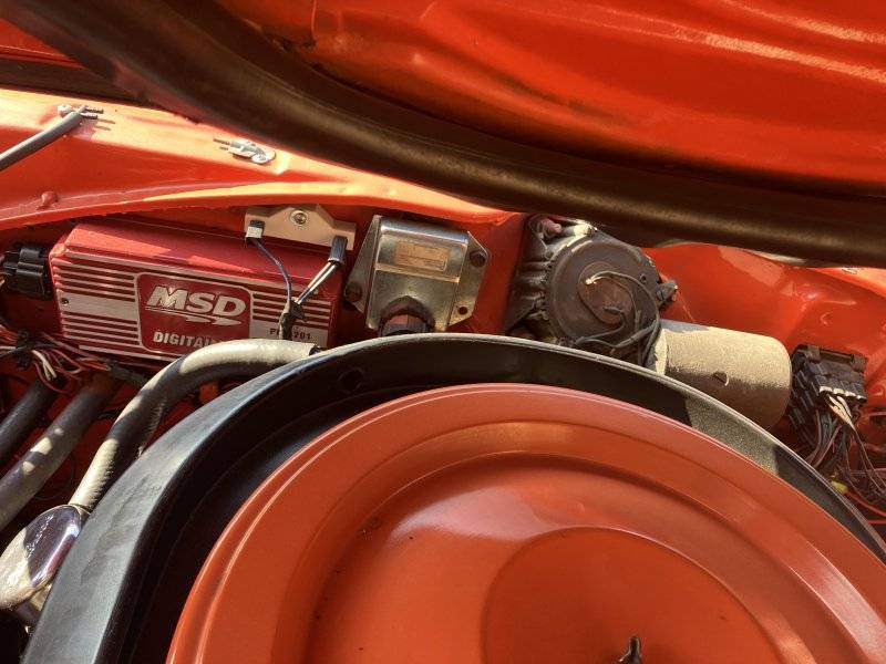

Right now I am trying to figure out why the tach is not working. As you see it has an aftermarket ignition system as well as the correct tach adapter, but the white wire running from the adapter is not plugged into anything. No idea why not. I would run it to that fuse block below but there are no tools at my current location or even zip ties otherwise I would do some experiments.
The other immediate concern is it runs on after stopping and pulling the key. In the original notebook he had played with the timing quite a bit for some reason after the rebuild. The last entry on timing has it 4 BTDC. Manual says 5-7, so I'm thinking this is not the issue.

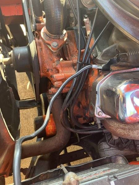

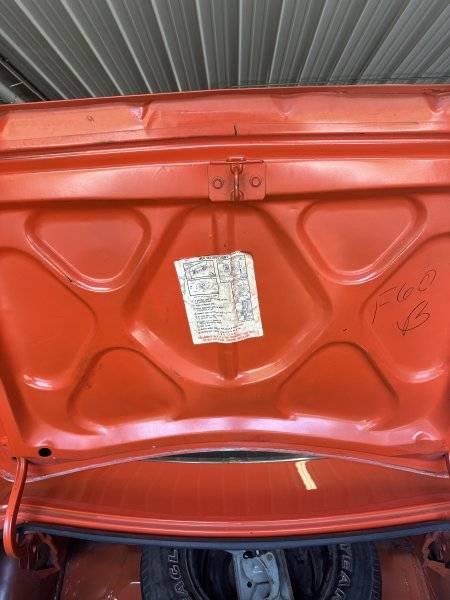

All that mess you see under the hood is just dirt. Not pitting. Everything clicks shut clean. All the options are factory. (I’d love a Go-Wing though). Ran a magnet over every inch of the car. And there is evidence of overspray on a few parts like the hood pins and vinyl which leads me to believe it was just the one respray and no body work has been done other than the trunk. Which will forever haunt me. The paint is at least 30 years old and looks great. It was always stored indoors and heated for the last 25.

Came with car. Fixed the timing today. Found the fuel lines leaking at the carb from the connection joints. Both of them.
Is the idle stop solenoid set-up correctly? Is the solenoid working properly?
Not my words, but the explanation I would offer if it wasn't already past my bedtime:
The solenoid is energized when the car is turned on - thus pushing the plunger OUT, against the low idle screw. So when car is running you adjust the idle screw against the solenoid plunger (which is energized and "out"), the solenoid plunger is adjusted so the slow idle speed (when solenoid is de energize, car off) is even lower than when car is running, thus keeping engine from "running on", ensuring the throttle plates are totally closed . . . hope that all makes sense . . .

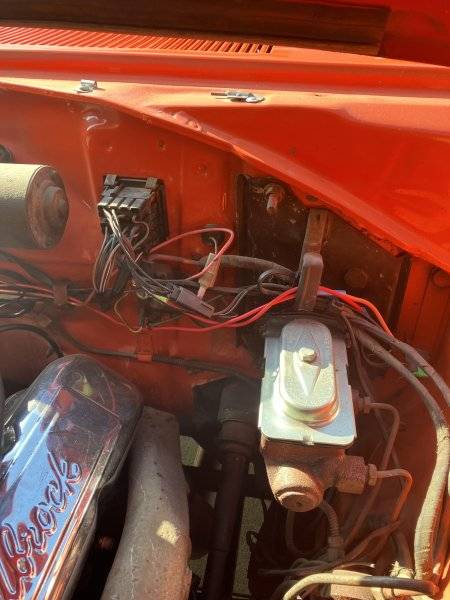

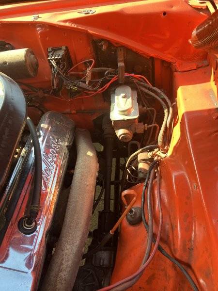

I was expecting to see at least a couple of loops in each brake line going to the master cylinder. Maybe they're down lower and out of sight?
I'll run a little test on that today when I address the leaking fuel lines. As far as the brake line, there is that whole nest of loops involved with the line lock. I'd take all that out if I felt like getting into that mess right now but don't really have a good reason. Probably just let it be and see if I decide to swap in discs and do it then. On one hand it's sort of a cool era relic evidencing someone really ripped in this car, but I'd rather have a clean engine bay and fewer possible fail points.

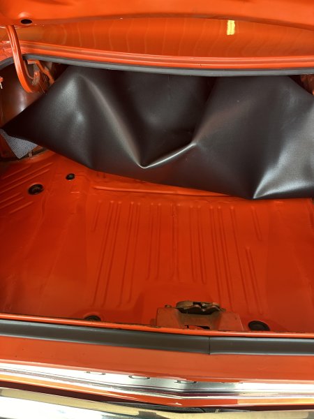

I bet you need some more initial timing and then less idle speed screw with todays $hit gas, and that should help the run on issue. On my Road Runner that came from Texas, I replaced the trunk pan and the quarters and drops were perfect. Just depends where the water sat after coming in a bad decklid gasket I guess.
I went to check the numbers back there and that seal was glued on tight. Makes sense if that's the case. My dad was saying the same thing. He had a Camaro rot through just from a case of Pepsi breaking open and forgetting about it for a few weeks.
My 70 charger PB drums had very little loops in the lines

There is no idle stop solenoid.
Hit 95 on the HWY 20 bypass just now. No problems. Fixed the fuel leaks and idle problems. Incremental improvements seem to be making a big difference so that's great.
