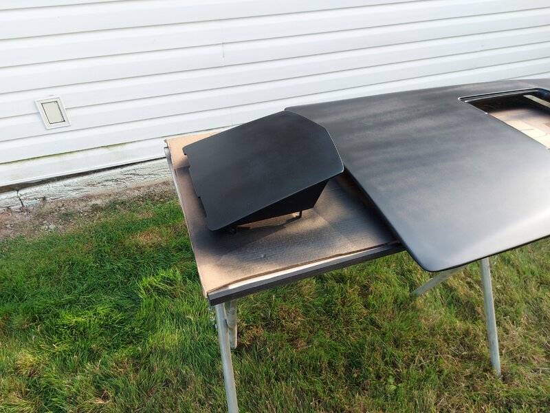

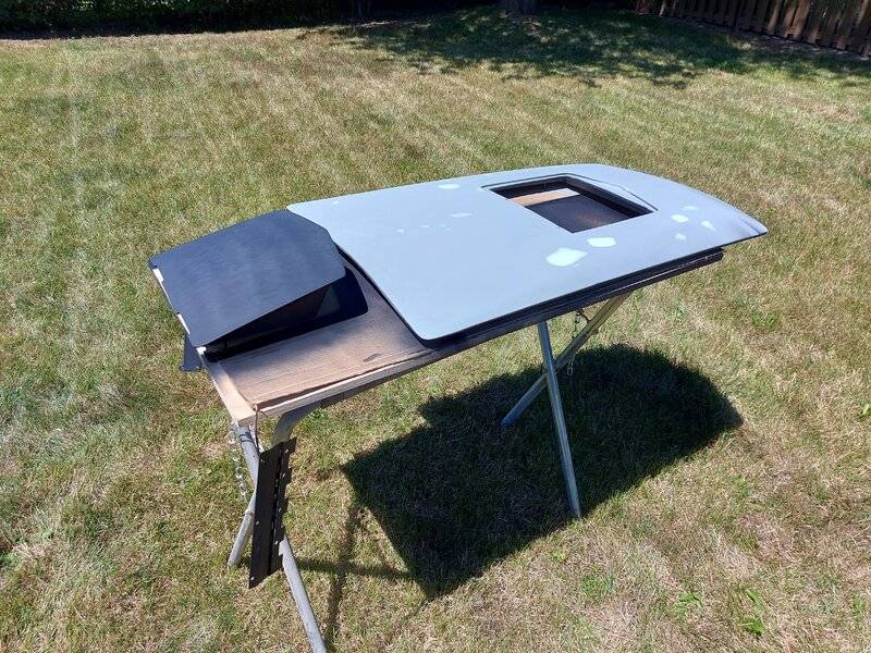

When I sprayed the underside of the Air Grabber....it went on perfect!
The topside..... not so much.
You may be able to see the streaking.
Anyways, it may be due to the excessive humidity we have had in this area the last little while.
Did I also mention that I'm painting this outside & nowhere near the car....
So, my neighbor, who's a body and paint guy said to try the Rustoleum 2X satin.
So I did.... the problem with that paint is it's too shiny like a semi gloss black, not a satin black. Not to mention every time I sprayed a coat something just had to land on the fresh paint...making me have to go back and re-sand it.

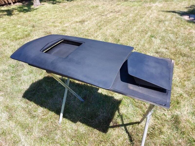

So my third attempt I thought I'd try a flat black paint.
Since the satin black was too shiny I thought maybe the flat would be just like the satin.
Well, I was wrong.

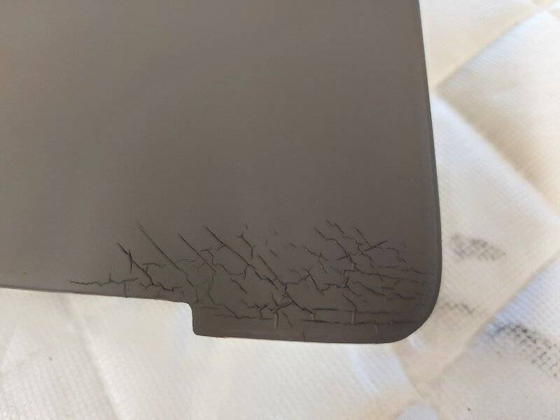

Not to mention the paint reacted and did this...
So, I'm going to wait till the humidity goes away from this area and try it again.
I'm also going to try painting it inside in my other garage attached to the house and I'll sit the Air Grabber insert vertically. Maybe I'll go back to the Mar Hyde satin black and give it another shot.

Do not despair. I'm a rattle-can guy myself.....and its all about the prep. You have to use a primer....not a 2x paint and primer. Allow 24 hrs to dry in a garage environment, then use a good satin paint. The Primer really is the key. The "stripes" you see there are due to rapid drying. You need zero air movement for these kinds of paints. They have drying agents in there that are very unforgiving. Prime, then paint for best results.

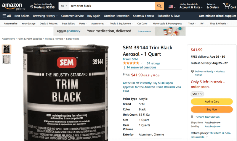

If the O/P is willing to pick up a spray gun...

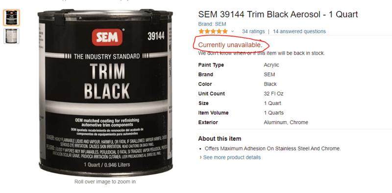

https://www.amazon.com/SEM-39144-Tr...ck&qid=1629641229&sprefix=sem+,aps,239&sr=8-4
Or a Urethane..
https://www.amazon.com/SEM-HR010-Ho...words=sem+hot+rod+black&qid=1629641328&sr=8-1

1 Wild R/T I clicked on the link you provided....this is what I saw.
So I will try the SEM rattle cans as there is a distributor not far from me.

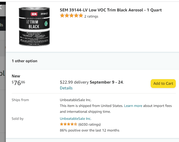

Whereas I get...
Must be a Canada thing.... Amazon discriminates against Canada....

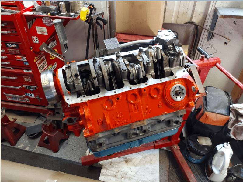

ne is a 0.03" over 360 with a set of shaved 'J' heads (60cc chambers).
The block has been zero decked.
Rods are the Scat 'H' beams.
Cam is the Hughes solid lifter cam p/n HEH3742A.
.534 intake lift & .543 exhaust on a 237 and 242 duration.
KB107 pistons.
Compression is close to 11:1.

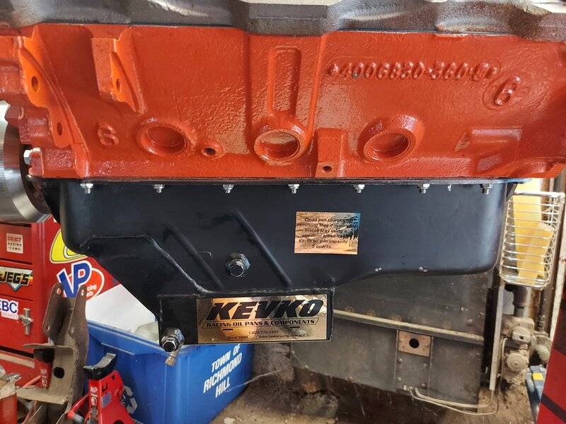

So I need to put stuff like the oil pans and other accessories before it goes to the speed shop.
So I'm prepping to put on the Kevco oil pan.
First order of business, get the studs installed.
And that's it for today.....man it's too frigin hot out here....

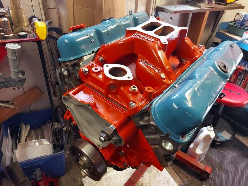

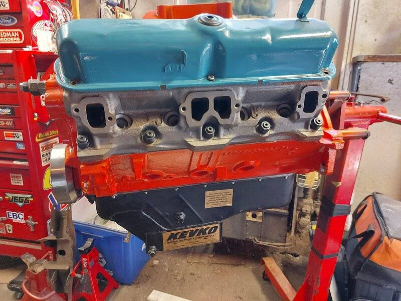

This weekend it was too humid to do any painting, so I had a chance to get the oil pan on the engine.
The water pump and dipstick tube are next.
My engine is in a one car garage that's attached to the house and even it is an oven just working in there.

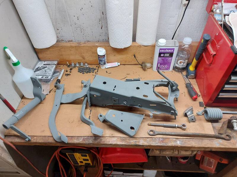

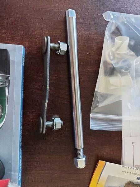

In the meantime I got the clutch pedal/brake pedal assembly out of the attic to have a look at it.
I bought the whole setup from my buddy who was going to convert his dads Charger to a 4 speed setup. But when his dad found out he said no way, so I bought all the bits from him.
Anyway here's the setup. He took it apart and had the pieces primed.

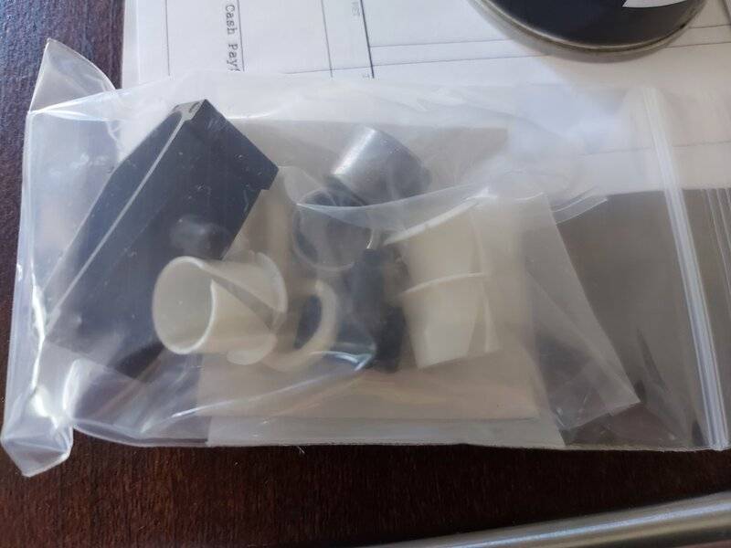

But the most important piece is missing - the main shaft.
So I placed an order with Brewers and my parts came in.

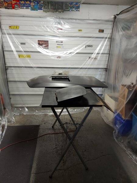

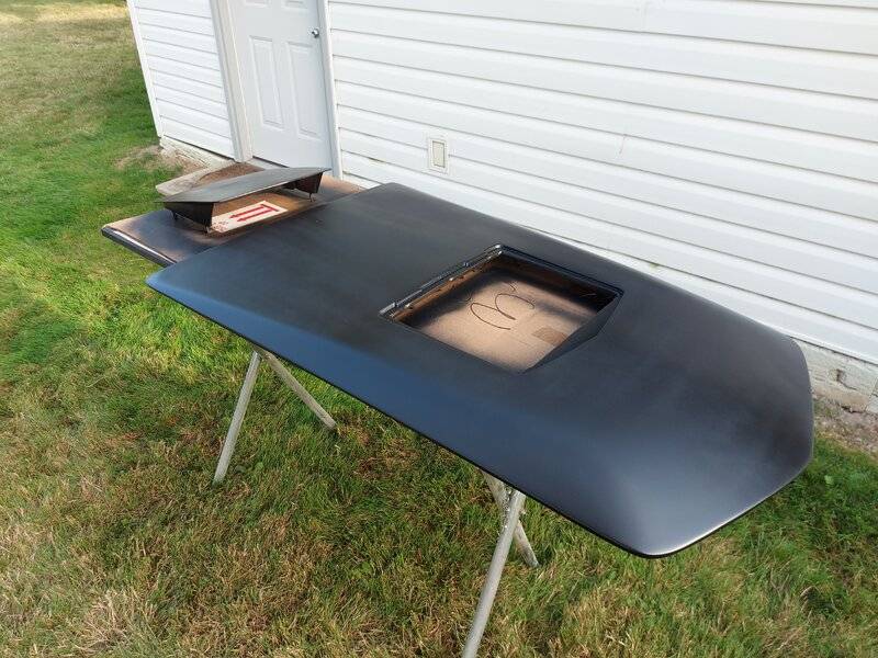

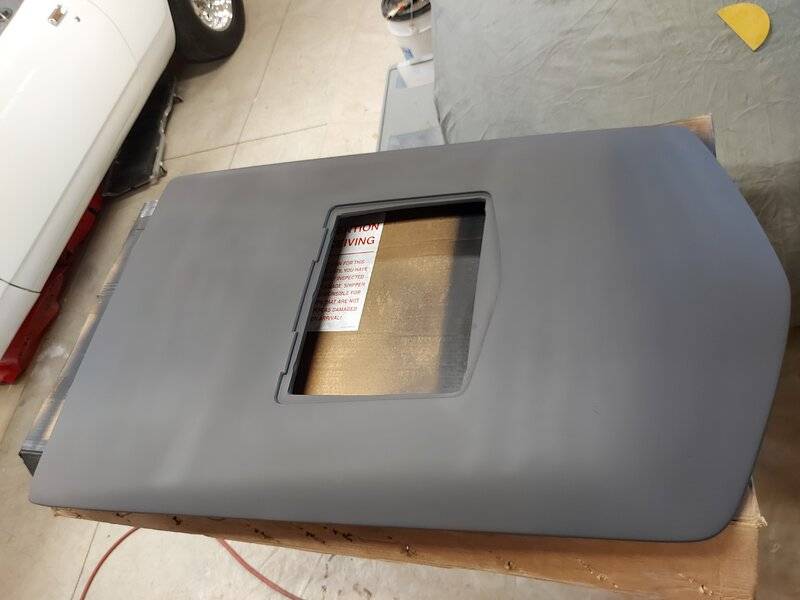

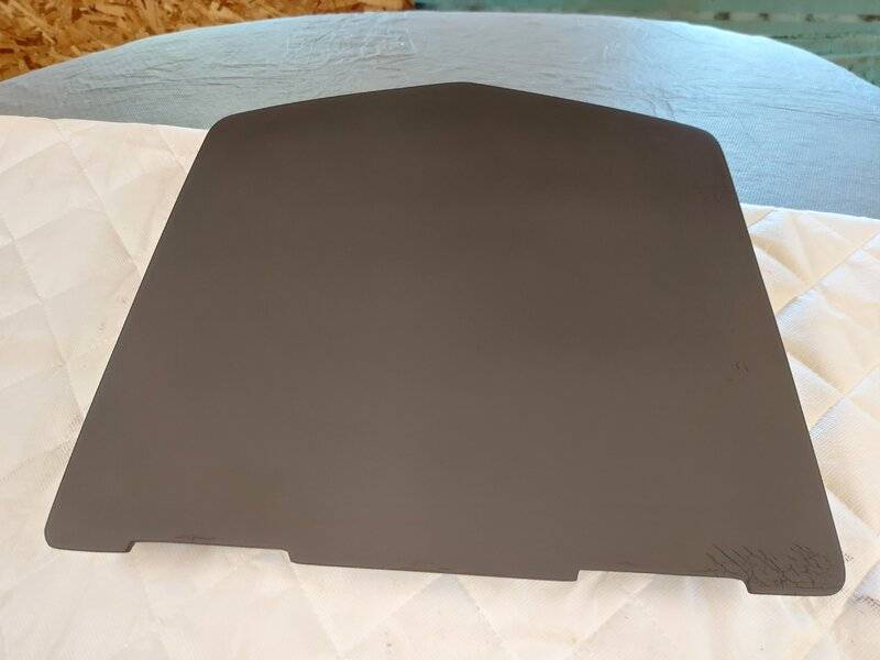

With the weather finally cooling down and the humidity gone I got back to painting the Air grabber setup.
I took the advice of member here and sprayed it inside.
First thing I had to do was to put the wife's Mini outside.
Then put up some plastic to protect from overspray.
I sprayed some black primer on it but the same spot on the door reacted so I removed the door.
Took it to the other garage to sand it down.

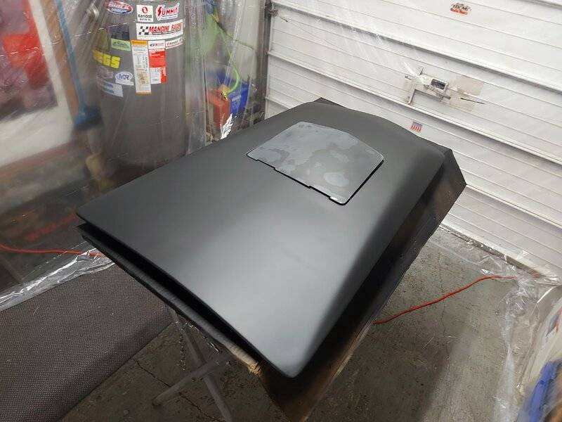

In the meantime I'm putting on light coats of the SEM satin black.
I cleaned up the door and put it ins its place on the assembly and am continuing with the light coats.
So far so good....fingers crossed.
You probably should pick up some sealer for the door...... That or start off with super light coats & allow good drying time between the first couple coats so they can act as a sealer..
