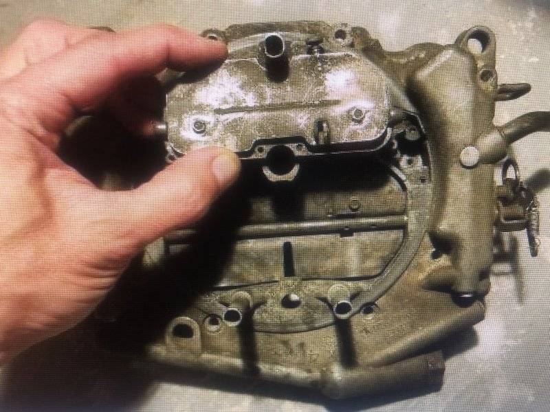

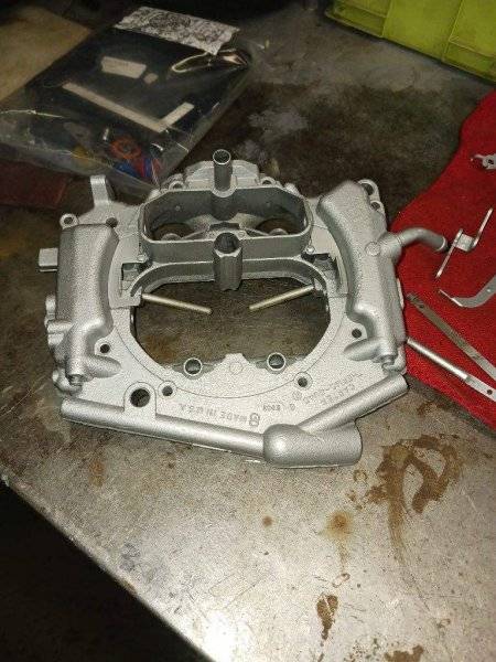

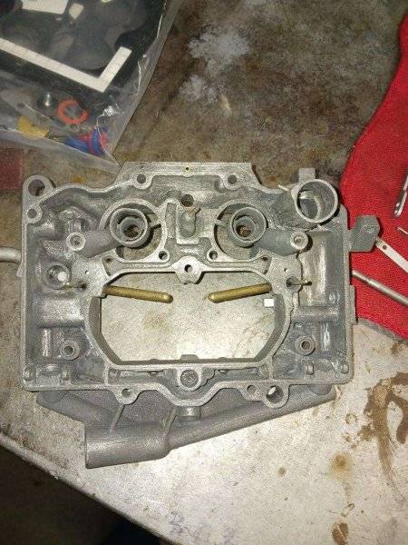

It was a whirlwind week, Adam sent me some pictures of the carb rebuild...
This is really exciting to me. But then the major issue of the missing choke plate...yup, the choke plate was gone! GONE!!! Oh noooooo!!!
That piece right there ^^^^^
This was a disaster. I reached out to a couple of super awesome FBBO members, and eventually coming through for me again was @HawkRod...
Within a few days the part arrived and for this I am so grateful

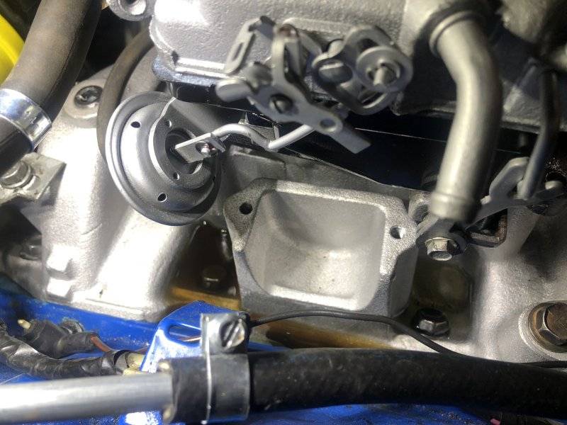

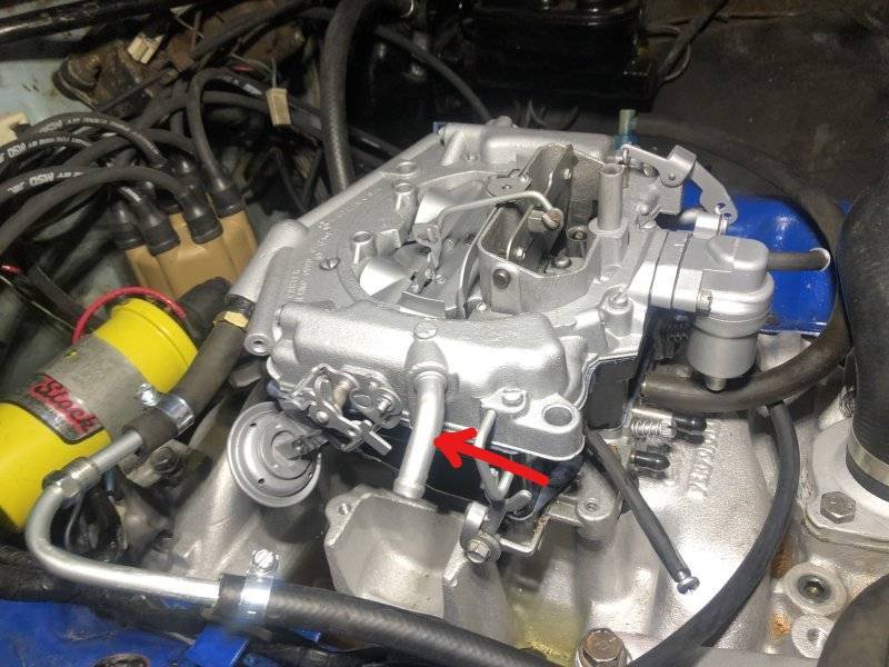

The Thermoquad will be hard to start without the choke in this well:
You can rotate this bowl vent for clearance to the choke linkage:
This junk can often be removed and blocked off:
A simple flat block off plate of 14 gauge sheet metal can be made fairly easily to eliminate that solenoid that is only used in later models.

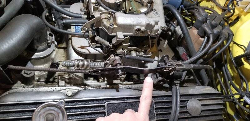

I'll see if I can get a couple of pictures of my linkage - maybe that will help as well.
Ok, a couple of pictures of my grungy, daily driver 73 Road Runner in case they help:

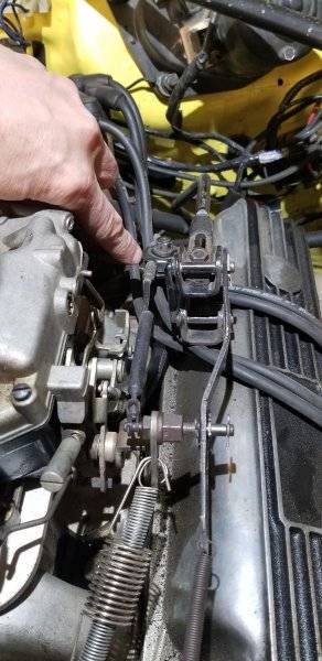

In this picture I am pointing to the kickdown linkage. To the right of my finger is the adjustment bolt you should use to adjust the kickdown linkage. Note also your linkage may look a bit different, but should operate in approximately the same way.
Here I am pointing to the bracket that holds the throttle cable. Loosen the nut immediately to the right of my finger to pull the cable housing backwards to give you more throttle. (By the way, the kickdown adjustment bolt is shown to the right of the throttle bracket nut)

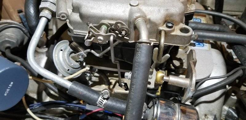

Here is the choke side. Might be hard to see details since this is a busy area.
Hopefully some of these help.
Don't drive it until you get the kickdown linkage hooked up correctly.
You can destroy the transmission by doing that.

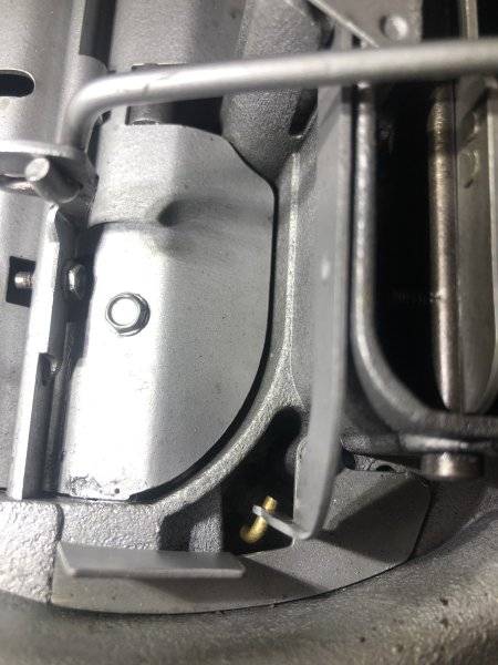

So tonight, Monday 28th Nov, I braved the heavy snow and low temps, and went into the garage, carefully undoing the eight bolts that hold the carb together, so I could pull the top off.
It was very hard to move. In fact, it didn't move at all. So I had a quick look about to see if there's any other bolts holding the top down. There was not BUT while I was peeking about, I noticed this...
^^^ The brass 90 that pokes through a hole in the needle plate (if that's the correct term) was not in the hole.
The one at the other end was in place though...
So I spent a while getting them both into place. It seemed awfully loose and the brass 90s could easily pop back out, so I gently bent the plate ends a little, which closed the gap and allowed both brass 90s to seat into their hole properly.
Much better! Excellent.
No.
I still could not separate the top of the carb. Is it glued? I don't know. I didn't want to pry on it by any means so I uncoupled the throttle cable and took it off, and over to my bench.
When twirling the carb around on my bench, looking for why I could not separate the top, I noticed some black flakes. Didn't think anything of it at first until I saw this...
A crack in the plastic, and the black flakes must be it breaking down and crumbling apart. I put barely enough force on the top plate to really see how stuck it all was, so I'm guessing it being drenched in fuel all week didn't help the plastic, and neither did the 22F temps. It's pretty clear to me that this carb is not supposed to be on my car.
So what next? This is a disaster.
