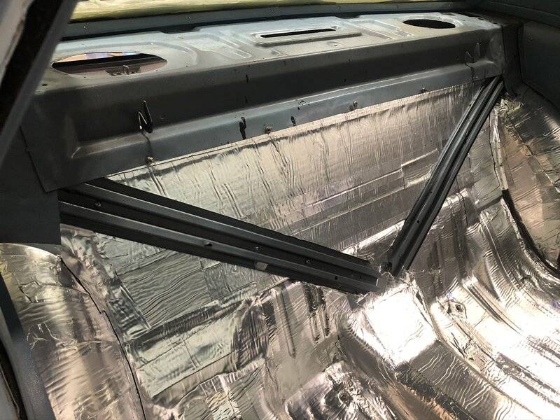

Rule #1, don't stick it near heat sources, or to be more descriptive, direct heat sources. On the VW Buses and Bugs I was first using Peel & Seal on, I never put it in the engine compartment, along the lower heater channels, or in the roof, or the underside of the trunk or deck lid where the sun can beat down.
Front firewall, floors, inside doors, behind the dash, and inside the trunk only. It did not smell, at all. Even on days that were so hot my aircooled VW would be vapor locking. I've never had any issues with smell, oozing/melting, nor staining anything.

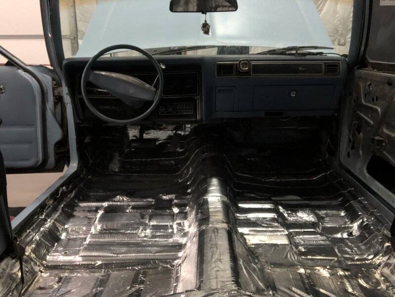

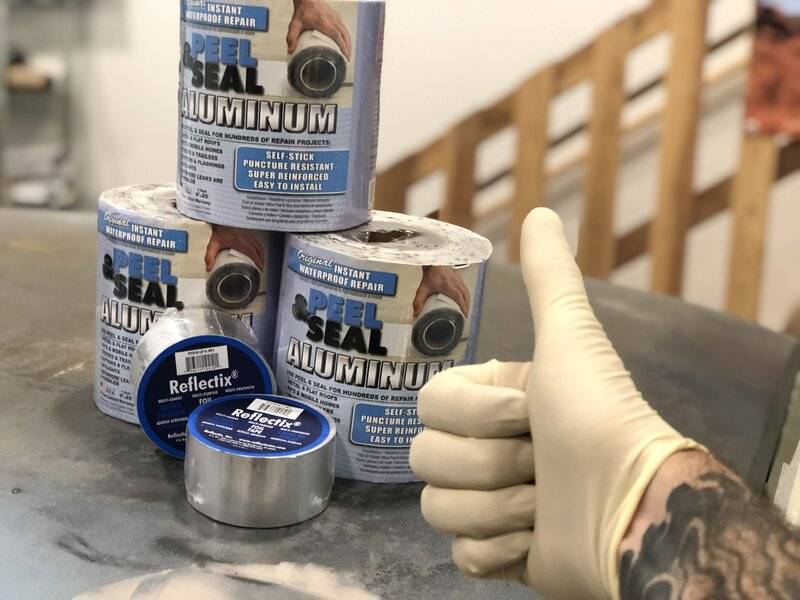

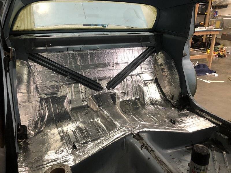

As you can see in one of my pictures, I bought the silver tape to seal off the exposed edges. I overlapped my pieces about 1/2", and ran that reflectix tape over each edge that you can see the bitumen (or whatever the brown sticky stuff is called).

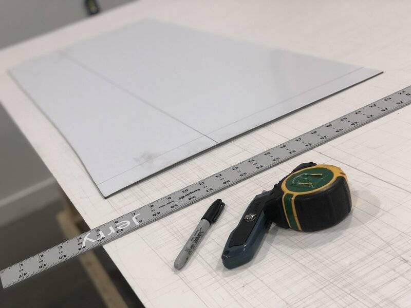

Applying this stuff is much easier on a warm day. I used an exacto knife to cut the pieces, and a hard roller of some kind to roll it on. The rounded end of a large screwdriver handle to mush it into recesses and low spots on the metal work. Cold days make the sticky stuff much slower to adhere. During the winter I've never had it begin peeling back up again. Ever.
Does it make a difference in dampening sound? Hell Yes. I put my '72 Bus into Vintage German Motors, to have the twin carbs sync'd. The owner Dave called me while he was on the final test drive, and asked me what the heck I did to my bus to make it so quiet? Apparently, he thought it was stalling at the lights, so tried to start it again, realizing it was already running... He couldn't hear the engine very much. I told him Peel & Seal, and some carpet. He recommends it to people now too.

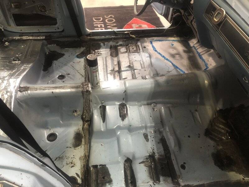

Degrease all the surfaces first. I like a microfiber rag and some isopropol alcohol.
