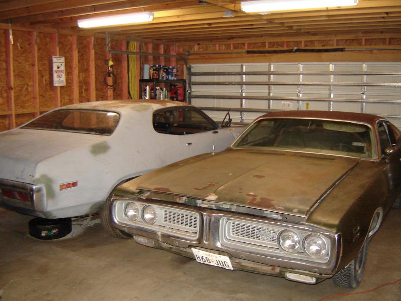

Got me a parts car... this triple green rust bucket will be donating.... bucket seats, A/C dash, rallye gauge cluster, power brakes, tinted glass, windshield trim, A/C firewall section, all the A/C hoses and condenser, and if I'm lucky under the green shag carpet... some floor panel patches.
Even my Dad and his 70' Challenger will be able to use a few parts.View attachment 146458
Those fenders will bring you a few Re$to bucks as well

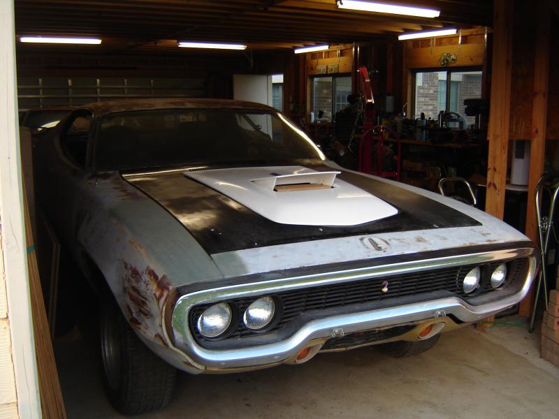

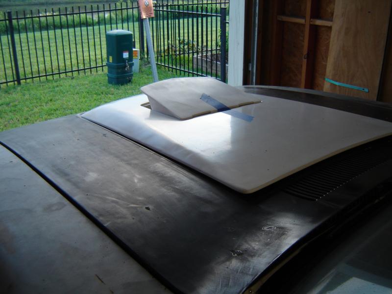

I got me a repop Air Grabber bubble and door today.
What do you guys think? This is the 4th option, after expensive original, PGs expensive and by all accounts, crappy repop, Stinger Fiberglass' decent part. I bought this off of eBay from a company that has all there stuff made down in Mexico, in a factory I'm sure would make an OSHA inspector faint.
It seems to be a decent part... the scoop fits the bubble pretty well, and the bubble fits the hood nicely up front although all 4 mounting pegs in the back are too tall and will have to be whittled down about a 1/4".
Its got all of the pegs for the studs molded in, as well as ribs across the underside for strength. The scoop looks a lot nicer that he one on Stinger's website.
It needs some smoothing and blocking.... and it will need some work up front because the bodyline in the center front isn't very defined.
It was about $450 shipped and was delivered to me in about two weeks.
I gave up trying to find a real one... I've had half a dozen people on Moparts offer me an original... and every single one flaked out as soon as I asked for pics. Plus, dropping a grand a battered, cracked original... then spending hours and hours repairing and making it look nice, only to drop it on a clone seems like wasted effort.

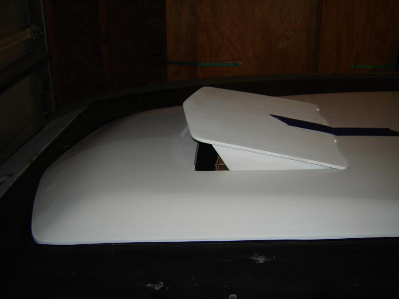

my sentiments exactly...when I was thinking of going that direction, I found a few that ppl were asking $1500 w/ broken studs and beat up. Seems like you got a really good deal-congrats!
