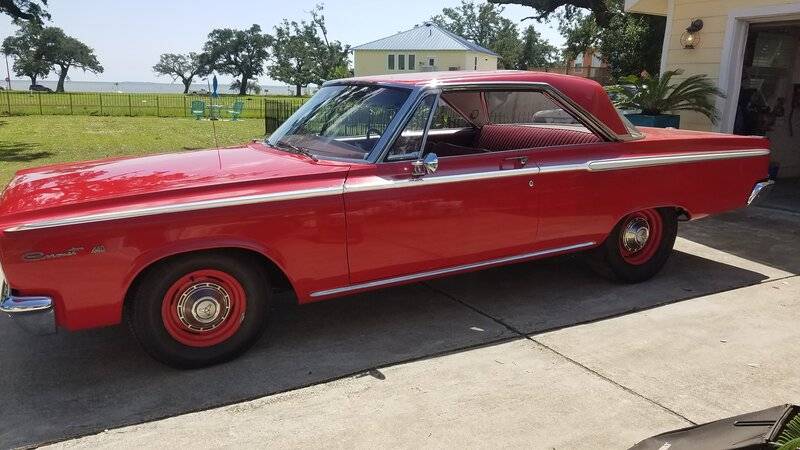

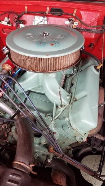

I recently purchased this "barn find" 65 Dodge Coronet 440. It actually has a factory HP 1969 440 engine that has been built for performance. It took me almost two weeks now to get it running right, but now I am hearing a strange tinny very noisy rattle coming from what appears to be the center area of the engine. At first I though it was the starter bendix not disengaging, but after replacing the starter relay the noise still is there. Im not very familiar with mopar engines. I sounds like it is coming from beneath the valley pan under the intake manifold.
Is there anything under there that could have come loose and bouncing around????

Sounds can travel, looking for a “tinny” sound, I’d also pull off your trans dust cover to see if there is anything floating around in there or rubbing.
To OP, heat riser(if stock manifolds), trans dust cover? But pull the valve covers & see what you see.
Before you start tearing things apart, If you have a stethoscope, try probing around in different places to see where the noise is coming from. Could be the fuel pump push rod. I had that happen once. The rod wasn't worn but the spring in the fuel pump was weak and not keeping pressure on the push rod. Sounded like a wrist pin or rod to me at first.
How about a video so we can hear it?

Thanks for the input folks. It took me two days to change the starter....that's gotta be a record! But the good news is the noise is gone! So it was a bad starter solenoid staying engaged. I was a PIA job, but I got to know the car a little better.....:D
It was a bad bendix not retracting.. but we know what you mean! Glad you got it sorted out!
