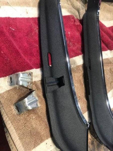

Powder coated all the front bucket seat trim pieces wrinkle black, turned out good.
All the Powder Coated parts on the car were finished by Specialized Coatings in Huntington Beach.
I highly recommend them if you need powder coating, very reasonable pricing and good quality.

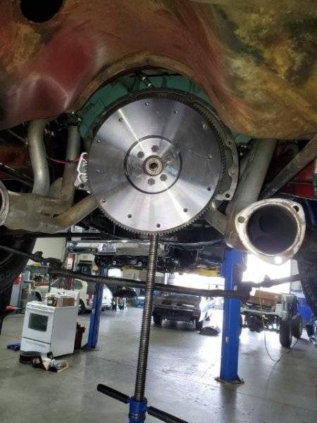

PIC's of the 727 to Tremec TKX 5-speed swap:
My engine was built by Dave Dudek in Michigan many years ago, and he's a very reputable engine builder I'm told.
I contacted him after I bought the car, but it was a long time ago when he built it, so he didn't remember too much about it.
He did say the the PO wanted a good durable and reliable engine, so that's fine with me, hopefully it keeps on runnin' !!
During the tranny swap, we ran into most of the usual problems with the older auto trans parts in there:
Starter clearance issues, headers hitting the bell housing and pretty much everything else, oil pan leaking, the list went on.
I had a rear main seal leak too, replaced that....twice.....finally good now, no leaks.
After all said and done along with the tranny, I replaced the headers, a new starter and new oil pan and everything fit nice, no clearance problems.
I installed a 440 source P/N 200-1142 oil pan with the Summit all in one G2339 Windage Tray with gasket top and bottom.
Highly recommend that Summit tray, no leaks anywhere around the oil pan now.
My garage floor is dry, crossing my fingers it stays that way!!
