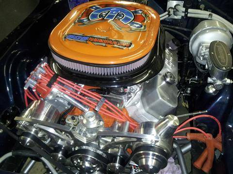

nah there autometer ultra lite 2 gauges i hacked up the back of the stock cluster and mounted them in stock dash so they sit like the originals but have the modern look . all electric too no mechanical gauges here.

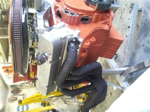

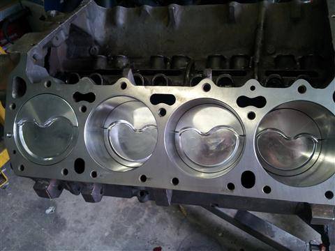

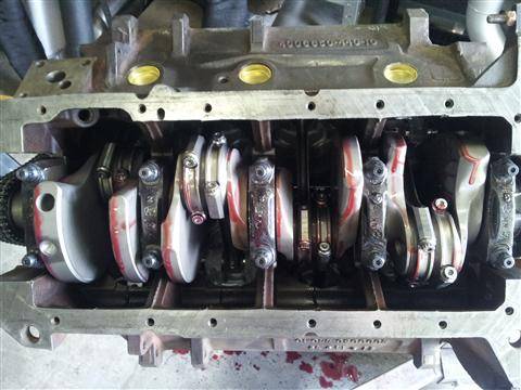

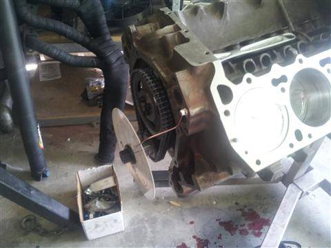

updates on my 440 - 505 stroker

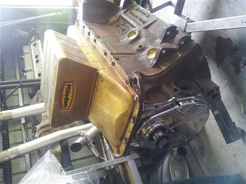

so finally got the motor back from machine shop.

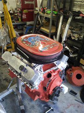

bottom end installed, cam in and degreed, oil pan and timing ocver on read for paint.
Looking good! Those guide pins for the heads seams pretty high in the photos, be careful so they don´t bottoms in the heads, keep those pictures coming!

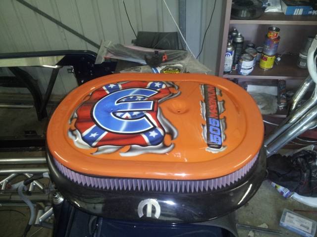

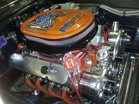

That air cleaner rocks. Did you do that yourself?
Wow, That looks like one mean stroker there! Great work....
It's all in the details and you seem to have that under control. Very nice work and I know you are proud of it.
Hey Benno are those 2 1/16" gauges in the oil/water/fuel/volt spots? They sure look like they fit well, but the factory gauges seem so much smaller than that. Did you make the holes bigger or do the Autometers fit right in?

the gauges didnt fit exactly i know its not ideal but i sikaflexed them onto the back of the pastic facia on the same angle the original gauges sat then a bracket to hold all 4 gauges together, sikaflex wont ever come off unless i cut it, this was the most effective way i could get them to work
