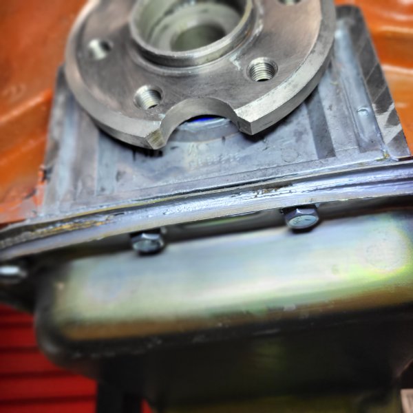

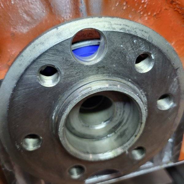

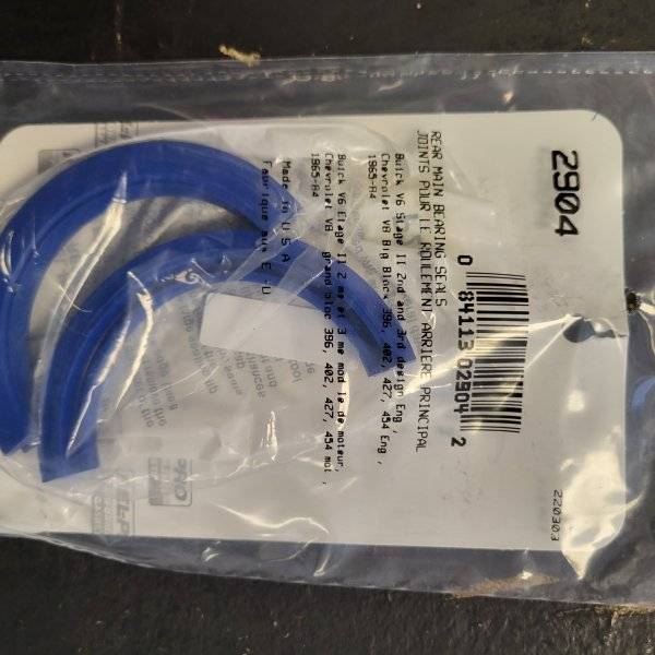

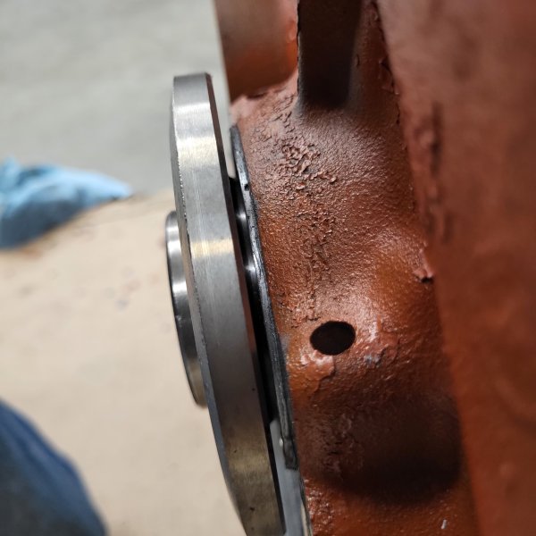

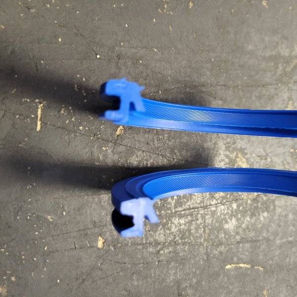

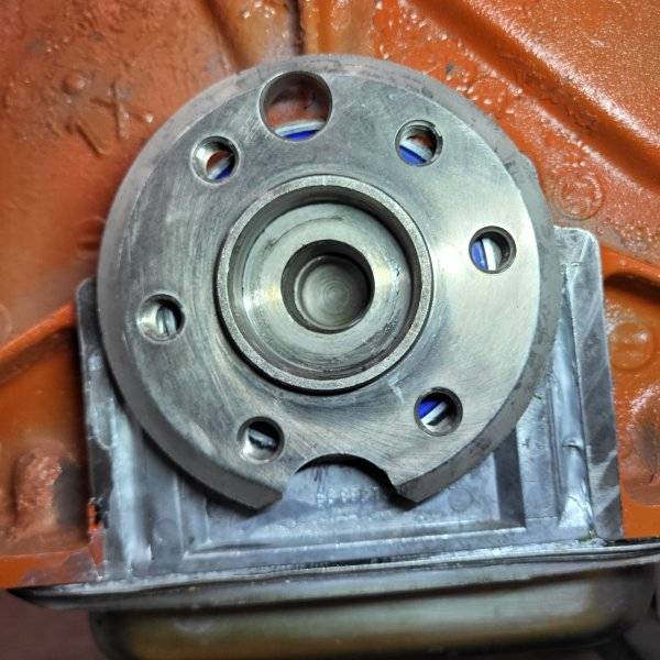

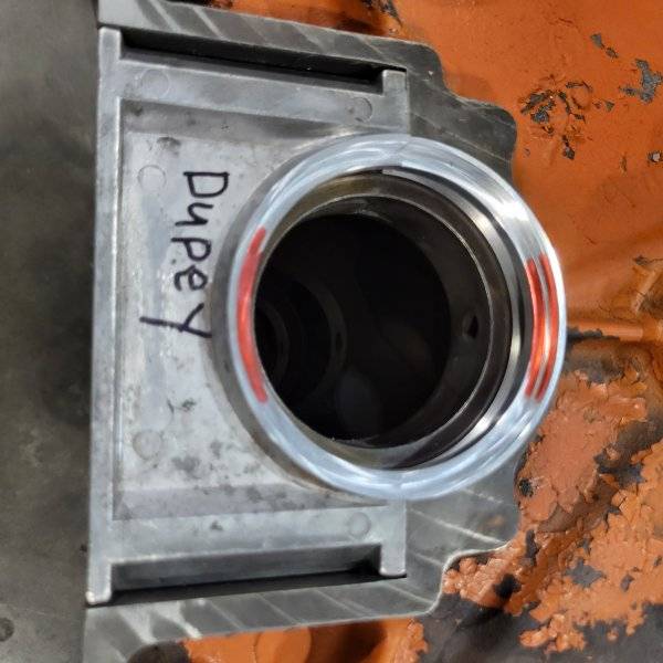

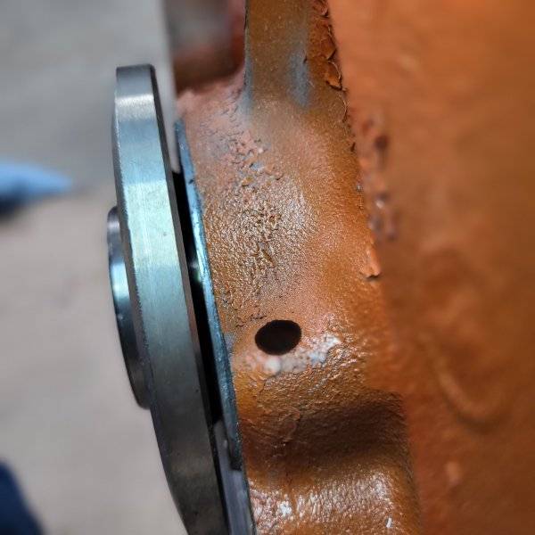

Motor is finally done and back home. Here are a couple pics of the Chevy rear main seal that they retrofit into a Mopar BB. It is quite a bit bigger and a far better sealing surface.
No doubt. I feel pretty good about it at the moment. They guarantee the rear main will not leak and do quite a few of these conversions.Nice Joel. Hopefully that's the end of engine follies!
What all is involved with converting it?No doubt. I feel pretty good about it at the moment. They guarantee the rear main will not leak and do quite a few of these conversions.
They machine the block and retainer for the larger od seal. And then weld up the crank in that area to match to the bigger id.What all is involved with converting it?
