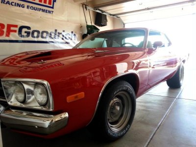

Pictures look great. The first one makes it look like it is coming from the bright lights of heaven thru the pearly gates and landing in your garage.

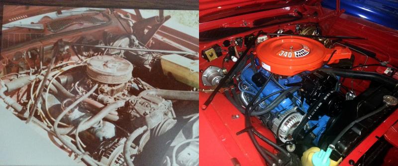

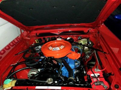

I found an old picture of the car from back in 1984. Here is one of the engine compartment then and now. Side story, you might notice that the original air cleaner was not with the car when I bought it, however, one night when I was out cruising, (Yes, that's what we did back in the day)this guy came up to me and said "hey, what are you doing with my car?" I said, "Your car, ok, if its your car, then what happened to the air cleaner?", he said "its still at my house in my garage!" I said, "Prove it, if it really is, go get it and I will give you 20 bucks for it!!!" Well, about 30 minutes later, sure enough he showed up with it and I bought it.

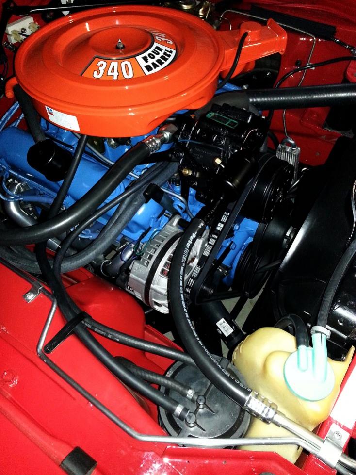

some bling bling looking real good

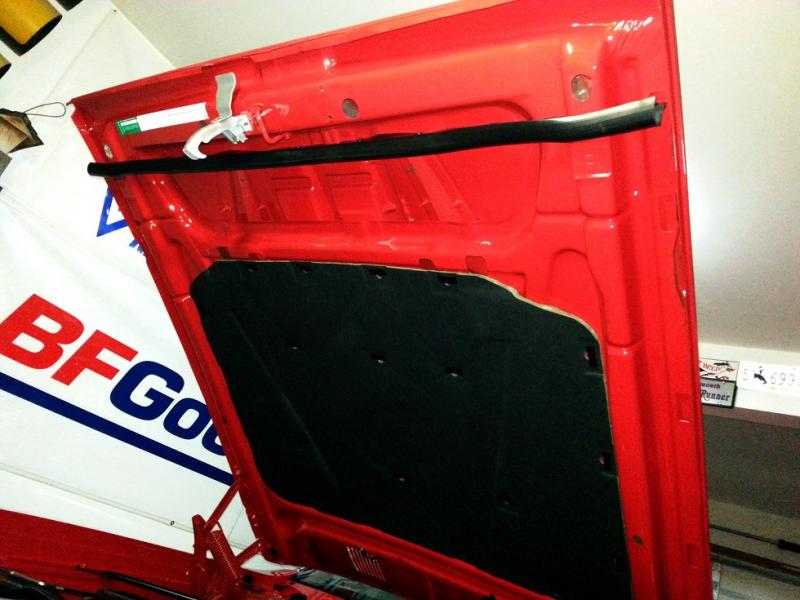

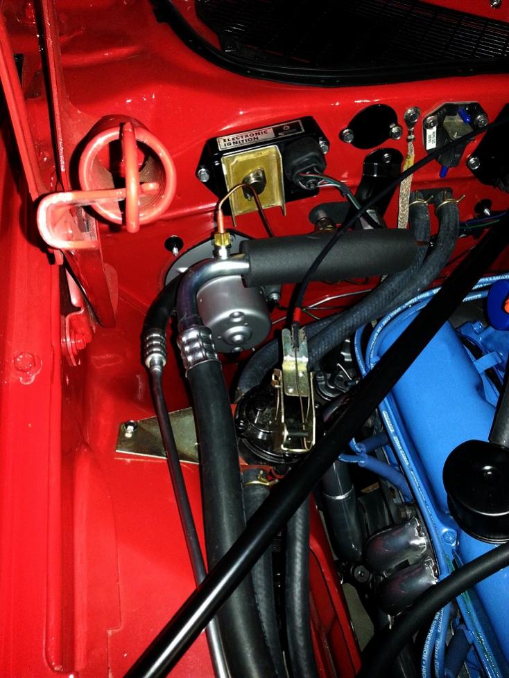

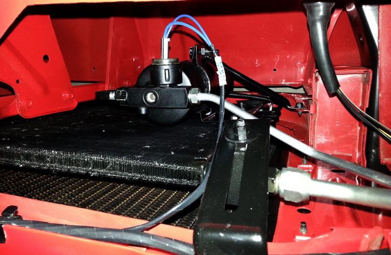

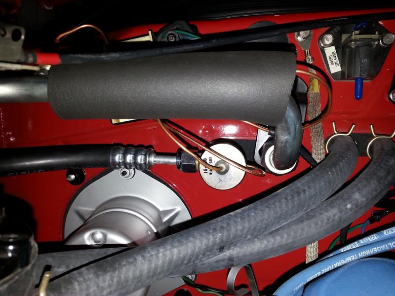

I got all the AC lines hooked up, just need to wait until better weather and some break in time before I take her to get leak tested and charged. Also added the hood pad and the engine bay stickers.
Hood pad and engine stickers.

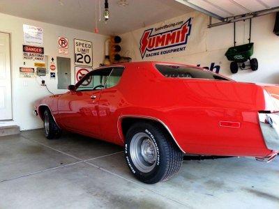

Well, I put the new wheels and tires on today, really wanted to sneak her around the block, however, slight problem, the passenger side tire rubs on the front of the leaf spring, back is good and driver side is good. Hopefully this is just a matter of loosening the spring box and front mount, and sliding it over on the perch a bit. The spring rod is on the opposite side from the driver side of the opening in the bottom of the box so I hope that's all it is!

What rim width and off set you running

The rears are 15x10 with 5.5 off set as recommended by some folks here, and they fit fine with 1/4 inch clearance to the leaf spring except the passenger side front.
