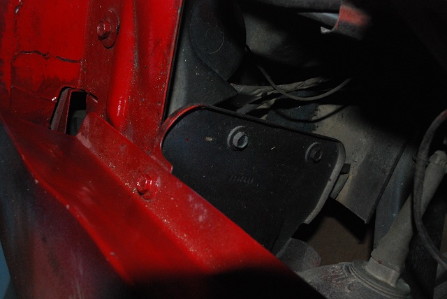

Ramairthree, here are some more pics of that bracket. It is another piece of sheet metal, that bolts in 4 places. You can see one of the attachment points below the headlight in the first shot and the other three are the hex-head bolts you can see in the second photo. The top one painted red and the other two that are black (for now). I don't have spares of these parts otherwise I'd be happy to help you out.

you have been a ton of help, thank you very much for taking the time and effort to post the info and pictures, I am goint to get some from a car being parted out now that I know.

Raimairthree, glad to be of assistance.

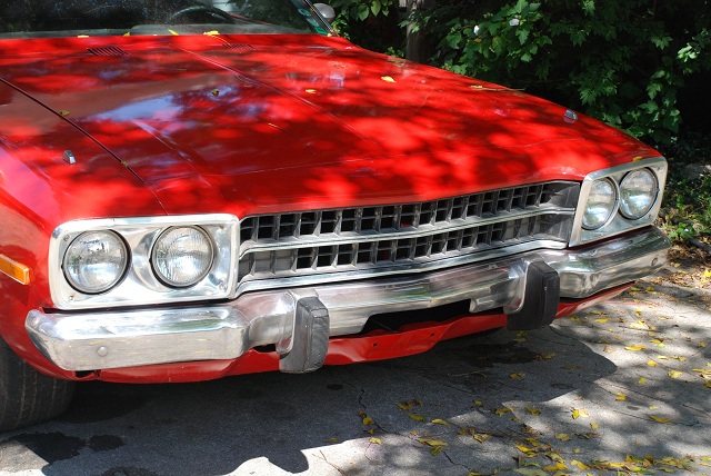

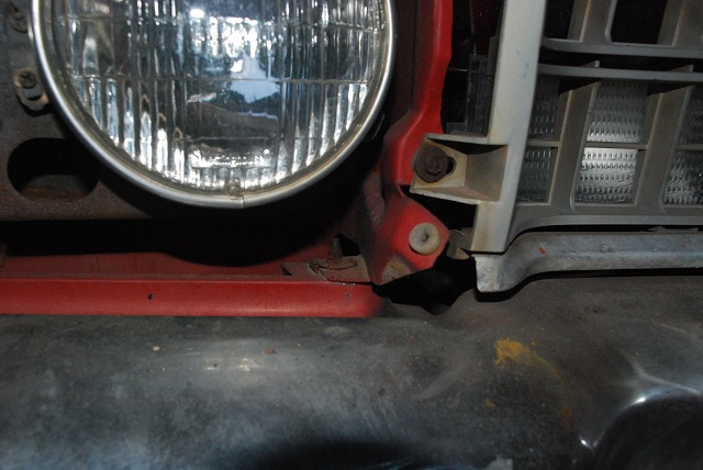

Thanks again for your help, I got some pieces from a car being parted out, and got them on and my bezels on right.
I made some tabs and gasket makered them to the sides of the grill where the grille tabs were broken off, and was able to srew the sides in also.

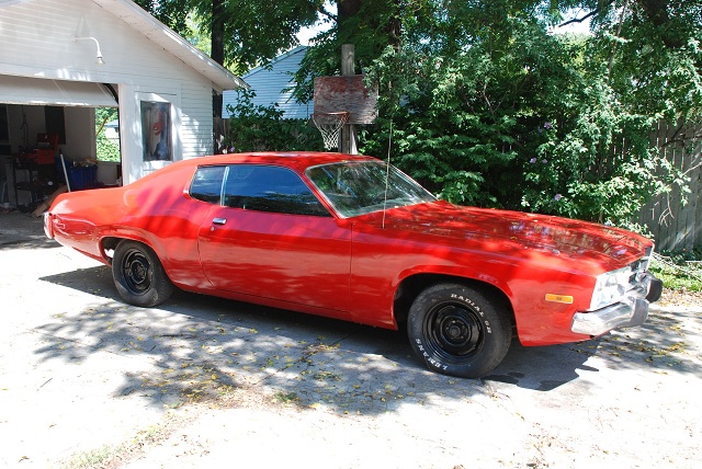

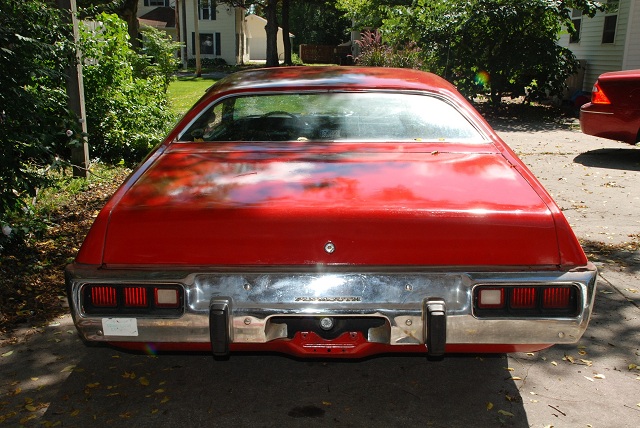

I've been doing a lot of work to my Satellite. I've been messing around with the carb tuning and the timing, trying to get it to run perfectly. I feel like I'm pretty close. Got the idle RPM set where it needs to be, etc. and she runs like a raped ape now, quite fast for "just a 318".
I put in the new shocks and wheel bearings today. Also discovered a broken sway bar mount that will have to be addressed, which explains the knocking sound I was getting while turning (was really freaking me out, only drove once around the block since I heard it).
But, as you can see in the pics, I've been doing a lot of work on the looks. Finished the Rustoleum paint job, and its a pretty good 10 footer. I didn't really take the time to do the body work because I just want to drive her around before summer. I'll do the bodywork over the winter and get it painted nicely over the winter. For now, this paint will do. The weird looking smudge on the hood and fender in the first pic is just the reflection of the roof of my garage, not a paint flaw. Painted the wheels Rustoleum black, will be looking for a set of chrome lug nuts for it. Also reassembled and polished the front trim. Spent some time tracking down a few electrical bugaboos, including brake lights, tail lights, marker lights, turn signals, etc. Now, all the external lights work as they should.
Next steps for me are fixing that broken sway bar mount, registering and insuring her, then driving the hell out of her until the snow flies. Thanks, all, for your kind words and encouragement.

Sorry to bump a slightly old thread, but whats the amber light in front of the license plate for? It looks hokey, but cool.
That amber light was a hackjob installation of a foglight, along with the two others in the grill. The previous owner (not Dad) cut into the wiring harness and really screwed things up. They are now long gone and I fortunately had a whole new front end harness, which is now installed.
