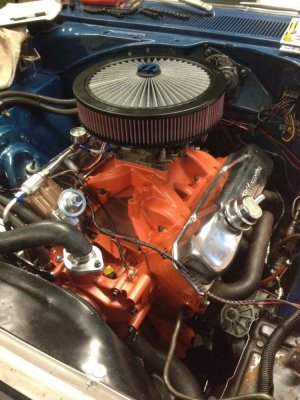

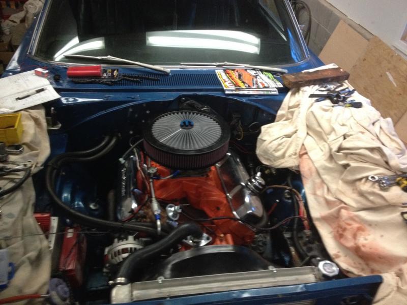

Engine is in and almost ready to fire. Just need to clean up / reroute some wiring, wrap the engine harness and fill the radiator and wrap up a few loose ends like throttle springs, spark plug wires, etc. Who knows... might fire it up this weekend. Oh, and I have a battery relocate kit on order, so I didn't bother repainting the old battery tray...
Oh, and I have to siphon out the old 'regular' fuel that the 413 drank and pour in some premium for the new girl.

I just realized the pictures of my budget didn't come through ok, so here it is again...
