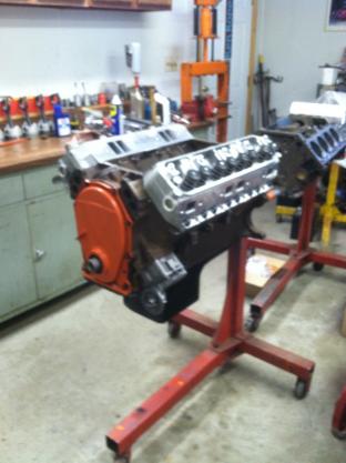

Some interesting news on the motor. Turns out the pistons are 0.003 ABOVE the deck. I knew the block was decked when I bought it, but I was told it was jus a cleanup. I think stock deck height would have left it 0.017 below if I recall. So instead of wrestling with just shy of 11:1 compression, we took a conservative line and went with some Cometic 0.060 gaskets. Back down under 10.5:1 and maybe on the high side for quench. Ah well, still a killer deal. Always an adventure.
On a positive note, decided to have the crank polished and the machinist got all misty on how straight the crank is and how nicely it was machined. Even brought his son into the room to show him "how it should be done".
Did you already have your cam picked out? You could get rid of some psi with cam timing.

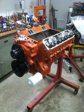

Well lookey here. My parts done growed into an engine.
Nice! Always good to see progress, isn't it? I can hear it thumping now!
Thanks, man, yeah I'm super stoked. Picking it up next week!
And thanks to you, look what your old parts done grown lol
Damn that sounds great! Man I'm super stoked to see that video, thanks for posting it. I just showed the wife and her friend and they said it sounded like the motor was growling lol.
Getting closer - just waiting on Smith Brothers pushrods and she's coming home to daddy.
