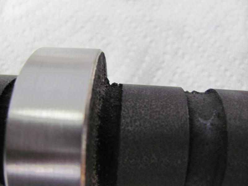

This is how it happens...............They don't remove the flashing between the lobes. The lifter is wider than the stone they use to grind the cam and the lifter breaks the flashing off and the pieces end up between the lobe and lifter. This is a Comp Cams XE284H-10 and I have seen it twice more on two other XE295HL-10 cams.
That is B.S. Nice quality..
