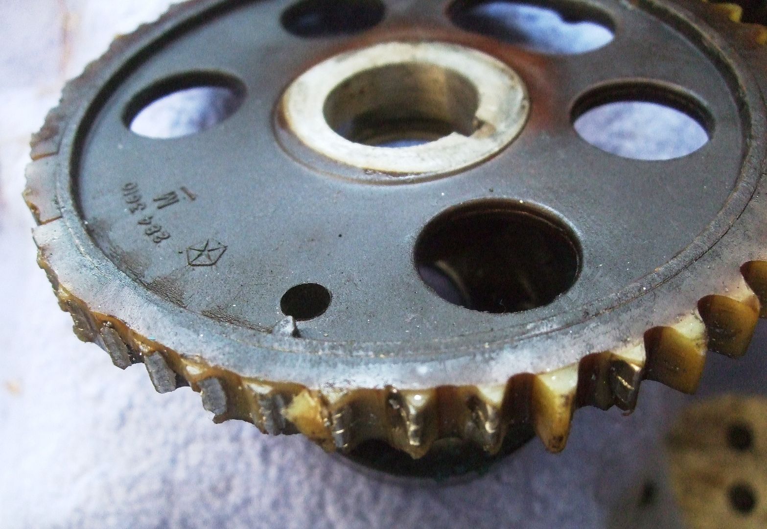

Back around 76-77, I had a 383 that wouldn't start once and it turned out to be this....
Well, nylon not plastic. They used a nylon over steel to reduce gear noise back then. Problem is, they didn't hold up well.
That gear is still serviceable. I see at least 3 good teeth... :lol:
Back in the day, this was called a "Silent" timing gear set.
Later...after back in the day it was a ****-set...gimme the gear noise...I always thought the nylon gear was nothing more than a cheaper way to produce cars.
Nope,it was for noise abatement. Saw a number of Pontiacs do it after fueled up at the gas station(when someone actually came out and did it for you)(no extra charge!!!!)
yeah that's when I encountered them in my GTO I had many years ago...
