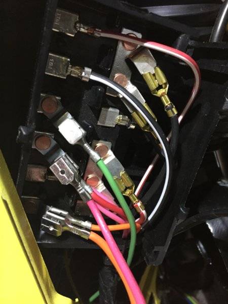

Don't feel bad, electrical is my weak point as well. But we're meticulous also. And you're right, one thing at a time works best. The factory schematics in the service manual are confusing also. Since I'm going for more strip than street/stock I'm happy leaving so much stuff off my car for now,, heater, a/c, door switches, etc.. I'll add things as needed later, while I kick myself for not doing them now. lol

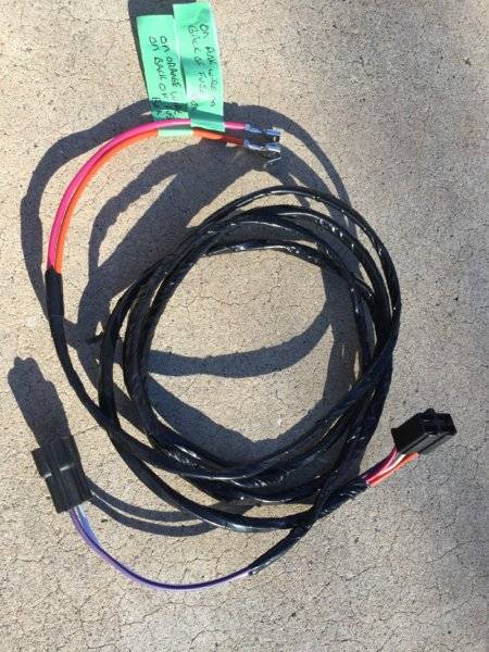

I found a guy on eBay (sniff-out-parts) who would make me the harness. I ordered one and he sent it right out. Thanks for your help Kid. Now I knew what to look for and how to install it.
Now I think that I have it about ready to fire up.

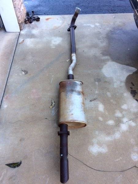

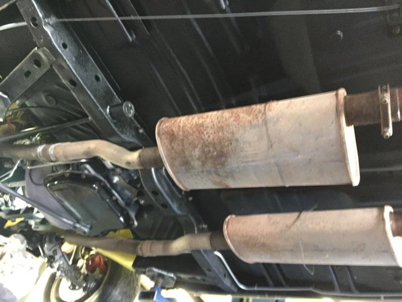

I have been working on getting things ready to break in my engine. I used some old used mufflers and pipe and custom welded some temporary mufflers to hang off the bottom of my car so the engine won't blow our ear drums (or the neighbors) out.

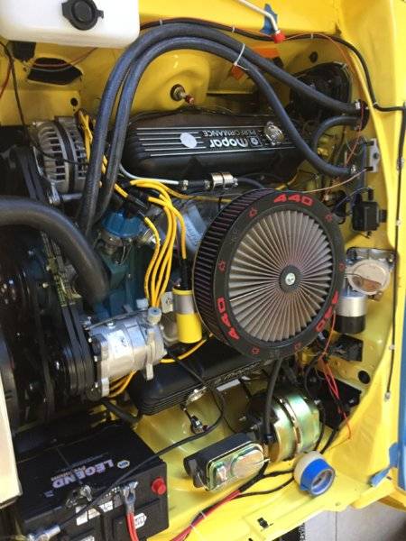

Jumped a big hurdle. I started up my engine! That is the first time this car has run in over 35 years and first time it has ran since I have owned it. I have been worrying about my engine for some time because I didn't have the confidence that I have done everything correctly. First time I tried it it backfired and wouldn't run. I found out that I had the distributor in 180* off. After turning that around it started up and seems to run great.

Very nice sounding motor! Good job! Looks great as well! Motivated me also as I'm working on my motor lately.

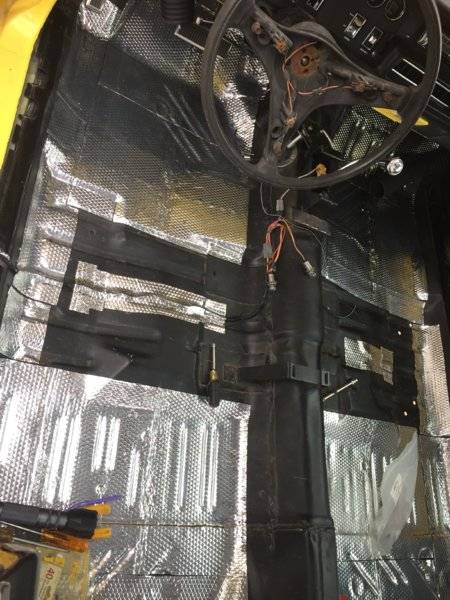

I’m still plugging away on things when I have some time. I got the sound dampening mats in now.

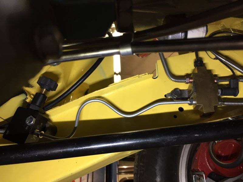

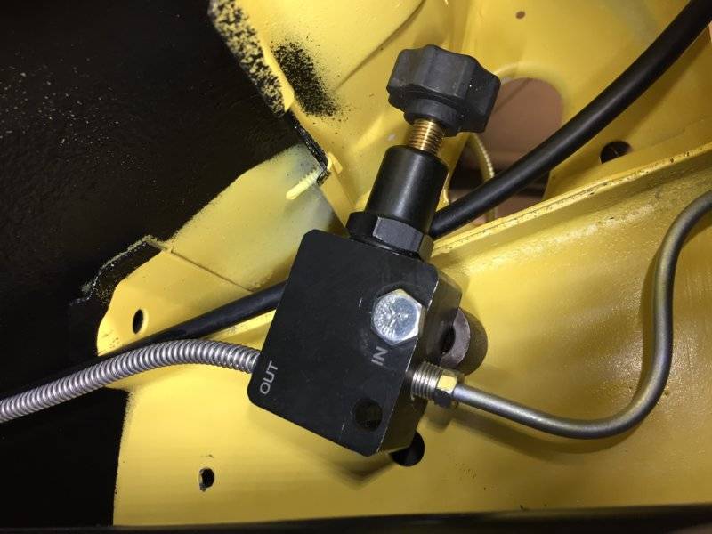

Now that I have my car running I want to try out the transmission but I also need some way to stop it so I worked on getting the brakes hooked up. I had got the kit to change my front to disc brakes but I left the rear as drum brakes so I had to add a pressure distribution valve between the rear brakes and the regular proportioning valve. I just need to bleed and try them out now.

Nice work on the engine compartment.
