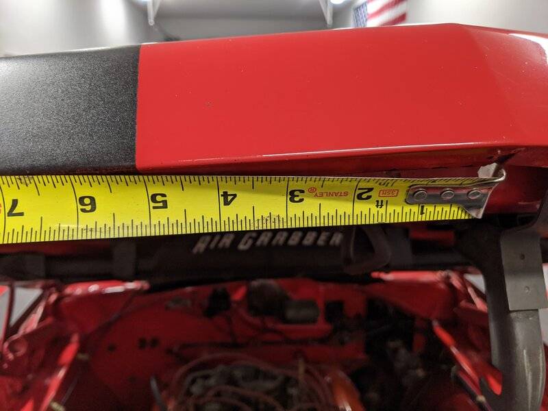

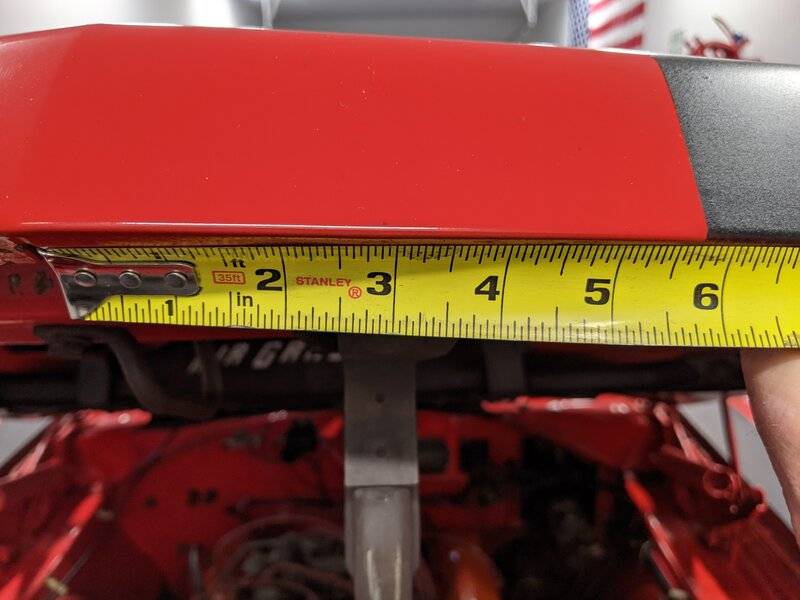

My Christmas gift wouldn't fit down the chimney
And we get all bent out of shape if something is off 1/4". They really didn't care that much back then, did they?

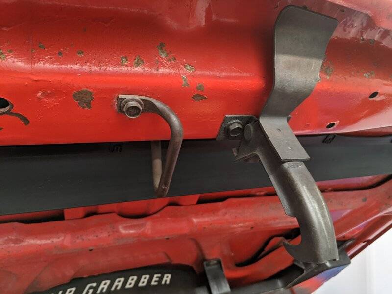

On another note Mark. It looks like the hood catch on the bottom side of the hood is natural, not painted? I always thought that part was painted with the hood.
I dunno. It's got the same patina as the secondary catch.
That makes perfect sense! Too bad that the car don't have the original chrome molly muffler bearings!
That's a nice car funny how today those little gaps and other things would cause a commotion but were accepted back when this was made .

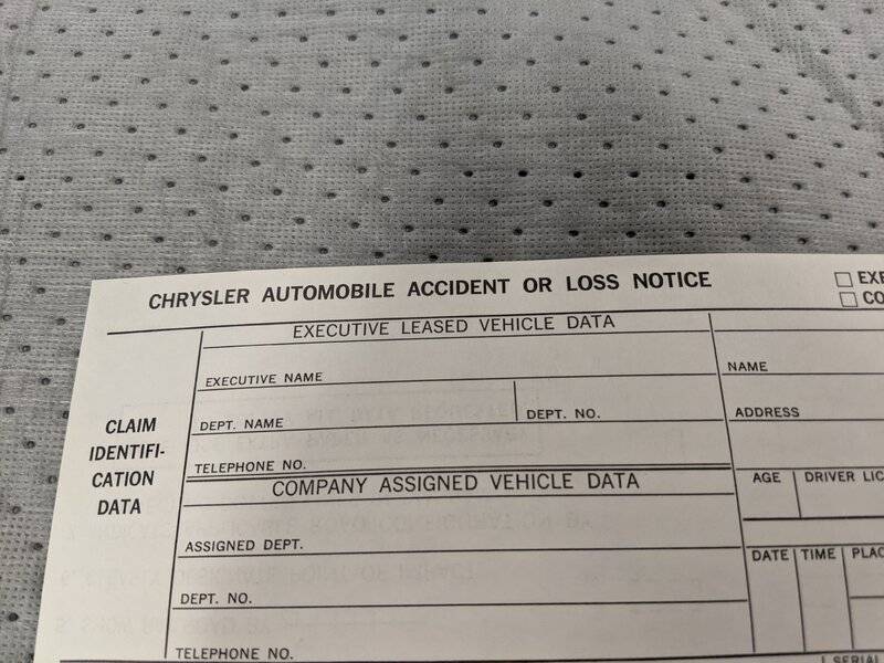

Another goody that was in the glove box. Four of these...

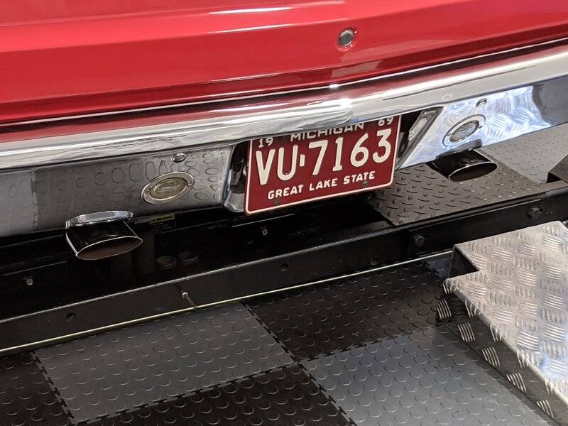

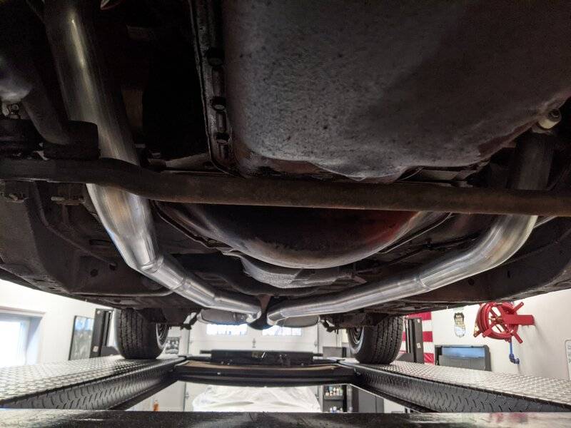

This weekend's bg project was putting on the stock exhaust manifolds and complete new exhaust system from Accurate. Although the manifolds are not the originals, they will suffice until I find a date correct set.

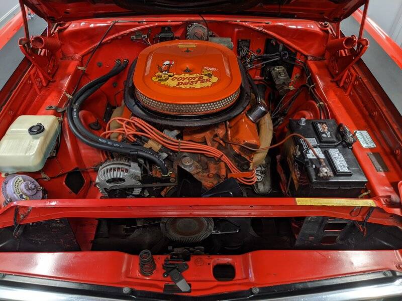

In the engine compartment, the old plug wires were replaced with a vintage set of 1983 Mopar orange wires along with the factory wire brackets. I did locate a hood release lever, put that on and removed the inside hood release cable that the original owner had installed right after he bought it. I sent the radiator out to a local shop to be flushed and pressure tested, but a leak was found, so I just sent that out to the experts at Glen-Ray. Unfortunately, they told me that it could take up to two months to get it back.:(
The original 52 year old coolant hoses were junk & the heater hoses went on and I changed the dual pulley alternator with a more correctly date coded single pully alternator that I had in stock. A non-working emergency flasher had to be changed and corrosion had to be cleaned out of the left side fender turn signal to get that working. Everything electrical in the car is working as it should.
In spite of how nice it looked on the surface, this car was in need of a good amount of TLC and because it's been sitting for so long, that's not surprising. Although I wasn't expecting the brake & radiator problems, it hasn't been a bad project for me to tinker with.

What mufflers did you go with?
Alternator date codes are (week - year). Looking at the picture posted it appears to be 3 - 68, or third week of 1968. This would be extremely early for a May 1969 built car. Even if the date is 3 - 69, it is still early but at least in the ballpark. Can you see any of the pinwheel date codes on the alternator. There will be one on the front and one on the back.
D
I got the skinny on the alternator when I talked with the original owner a couple weeks ago. he said that there was a problem with the alternator that would cause it to shake & loosen up the main pivot bolt that goes through into the head. Eventually, the bolt broke off into the head and a new alternator was put on under warranty and that's the one that came on the car.
